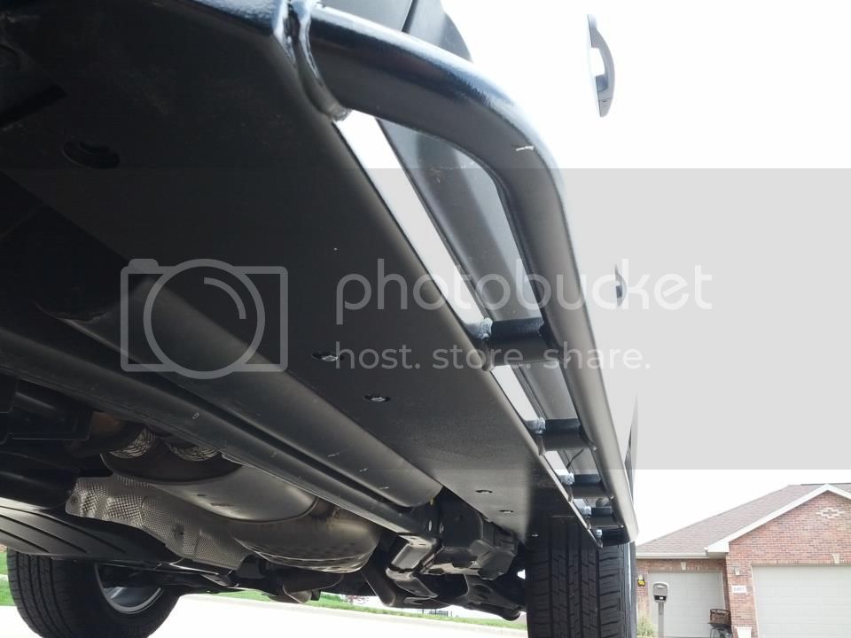

So, I got the Voyager sliders a few years ago and I really like the design overall. The round bars are really nice and they have some pretty decent coverage without being as heavy as the other options. They are very strong and certainly can be used as real sliders.
I did have rust form on mine, but I sent them back to voyager and they totally stripped and re-zinc coated them and powder coated them for me without charge. Whatever they did this time worked much better. I just checked mine and they have a little bit of edge rust but are in good shape. I usually just touch them up with a little paint. I assume that most steel sliders will rust a little, just like the rest of the vehicle.
Fitment on them is perfect and it is pretty easy to install them with a floor jack.
I am mixed on the tactical 4x4 sliders.. i know they must weigh more and I don't like the square look quite as much, but I think I would be willing to try them out. I'd like to get the matching T4x4 rear bumper and it has a square step thing on it.. so that would match better.
If anyone is interested in buying mine I would be willing to sell them. They DO ship via UPS (two 'packages'). Just PM me if interested. Forum members would get a fair price.
This picture is of them when they were new. (note, they also bolt along the door sill, so more than just the 6 or whatever on the bottom.)

So, I got the Voyager sliders a few years ago and I really like the design overall...I did have rust form on mine, but I sent them back to voyager and they totally stripped and re-zinc coated them and powder coated them for me without charge...
That's very nice of them.
I called and had a long conversation with the guy last week, about racks and sliders. At the time, he told me they zinc coat and then powder coat the racks, but the sliders are just powder coated. So, clearly that made a difference when he re-did them for you.
EDIT - my comment above is incorrect. They hit them with a zinc primer and then two layers of powder coat.
Interesting.. so mine or special zinc edition sliders. Let me know if you are interested in mine.
edit: I found the shipping receipt. From Iowa to Florida it was $172 for UPS. So not bad, way easier than freight.
