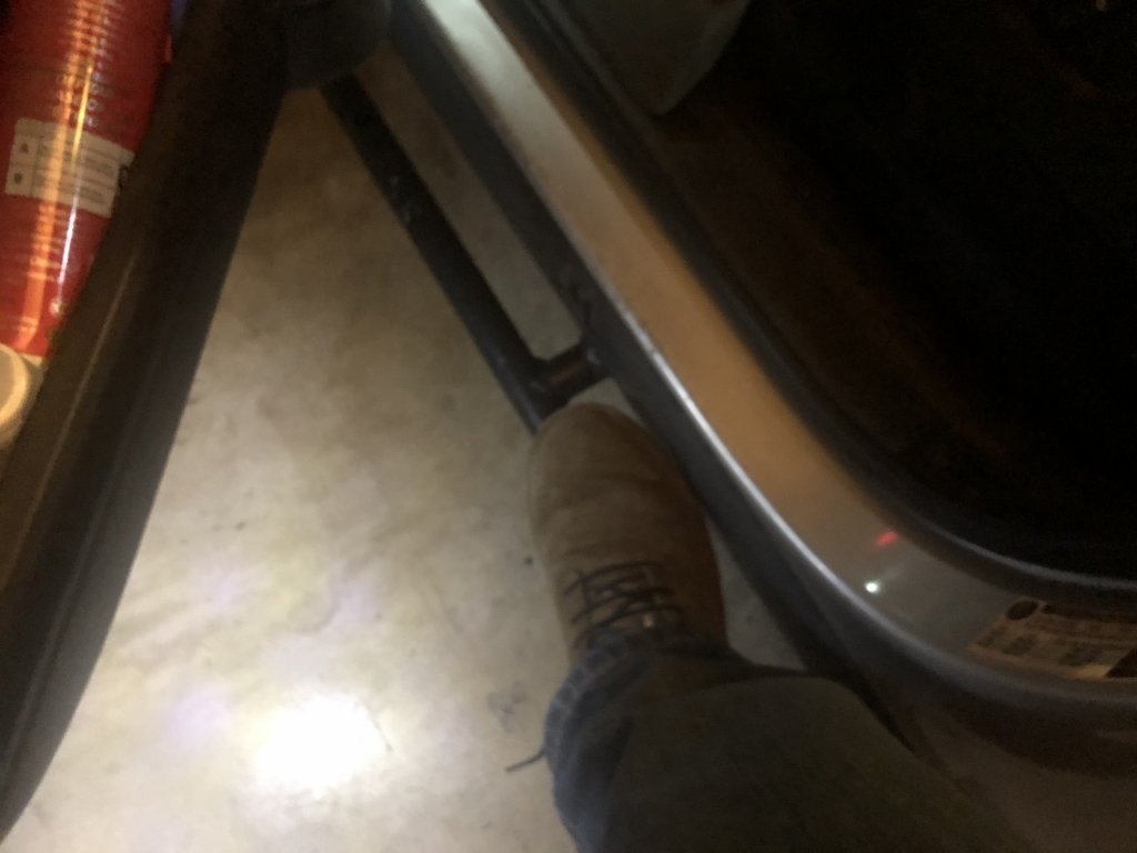

How many inches do the terrafirma sliders stick out? Do they allow you to put your foot on the tree bar to help with getting in?
They stick out flush with the side of the doors. They are just as wide as the LR4, no wider. And yes the tree bars act as side steps. I do recommend grippy tape, for those wet days.

They stick out 2.75" which for me isn't really far enough to be useful as a step, especially when they're wet. I dare say some grip tape would make a difference though.

I really wish my T44 sliders step stuck out more. Its too narrow. I kinda miss my voyager steps, they had two surfaces your foot would use. I have thought about adding something on top as a step surface, but im not sure I can make it look good.
