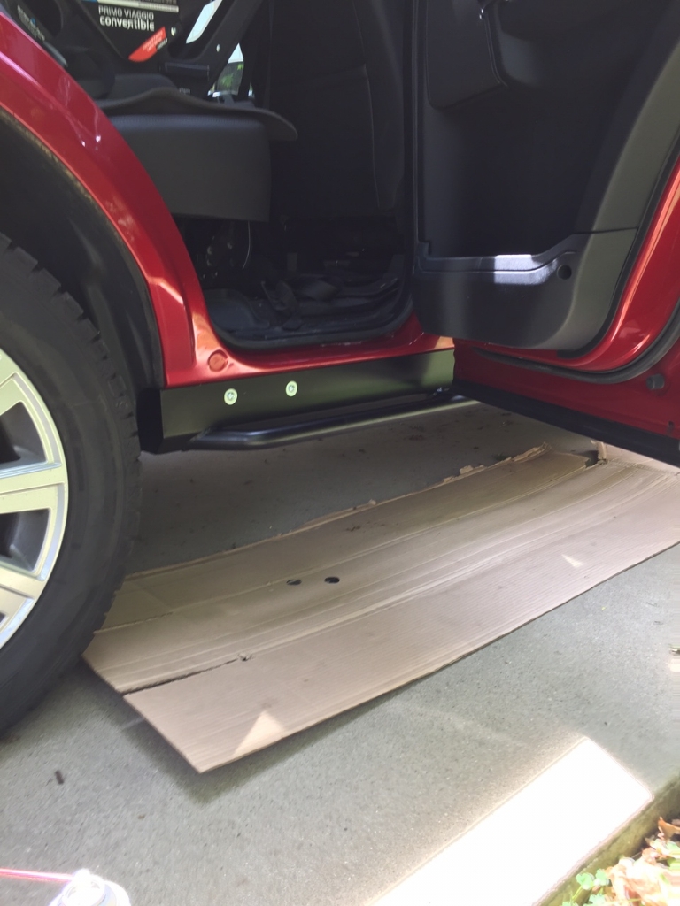

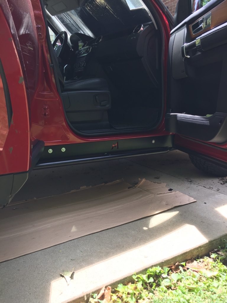

If I remove factory installed running boards, what's it going to look like underneath? Am I missing trim that is supposed to be there or will I have a dark black lower molding rail that had been shielded from the sun for years?
In any case, now that I got the wheels and vent painted, that silver rail on the running board has to go...
I love the way the oem wheels look painted like that. Remind me what you did to them? I have those same wheels for my winters and now I want them to look like that!
If you take off the lower trim parts (like I did) to put on sliders, it just looks like my last picture. You can see the white body paint under the black side trim a little bit.

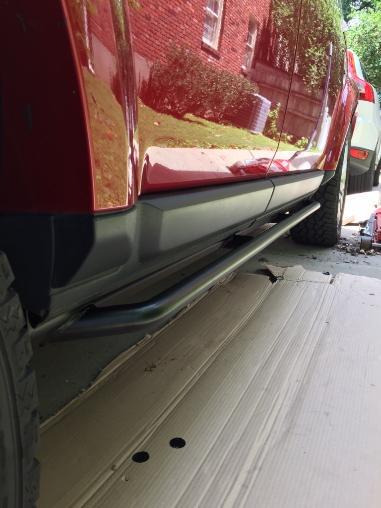

So has anyone installed the newer, steel Terrafirma sliders? Do they require as much modification as their aluminum ones did?
aakempvt
Oct 15, 2015
34
14
I just installed a set this weekend with no modifications on a 2012 LR4. However, they do make minor contact with some hose clamps on the passenger side and an A/C hose connector on the driver side. It wasn't enough contact to prevent them from raising into place so I didn't modify anything.
I'll probably pull them off in the future to check everything out and clean. All of the mounting holes lined up.
