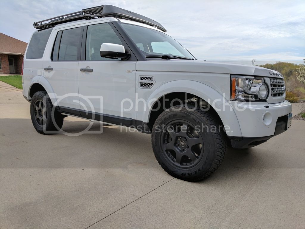

I just took the sliders to UPS for shipping, when I went to get out of the rig I stepped on the non-existant slider and just about fell over. Gah!
I didn't notice the weight this time. Last time I had them off and drove, i felt like it make some difference. But this time I couldn't really tell they where off. Butt dyno calibration isn't great I guess.

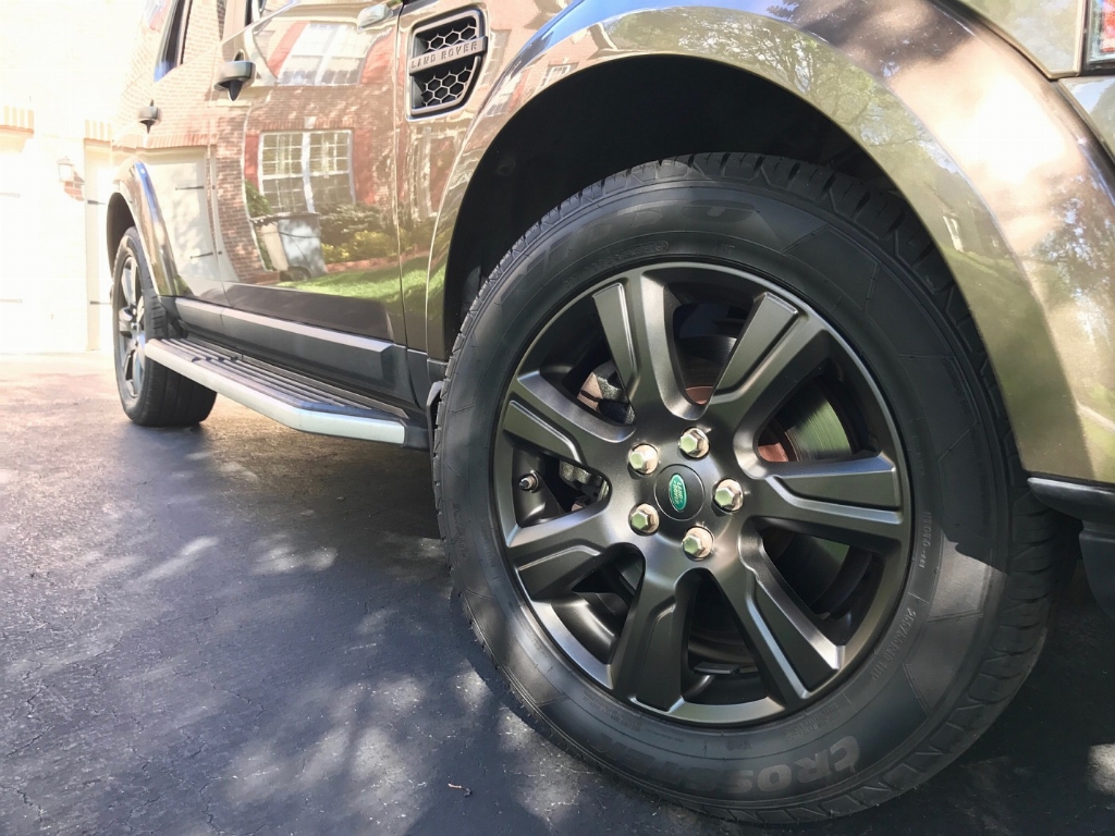

My new set hasn't arrived yet (I should have bought yours, they'd be on my truck by now. ;) ) so I'm still rocking the OEM running boards which I'm not a fan of. I was thinking of just taking them off before heading to the beach this weekend. I also don't want the running boards on for soft sand driving... they look like they could become sand anchors.
But now that I see a picture of your truck looking like a Donald Duck with his pants down, I'm keeping them on. :)
I think you're probably right about potential hazards of the OEM running boards.
