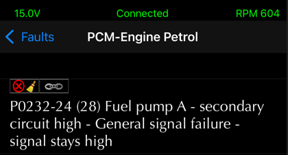

Great to know Jimmy - my battery is new a few months ago so keep that in mind. I checked my scanner again today and I'm still code free (not counting my chickens though!). I was getting this code (like you a fuel pump issue):
Which went away with the aforementioned battery change... Keep me posted, misery loves company!
