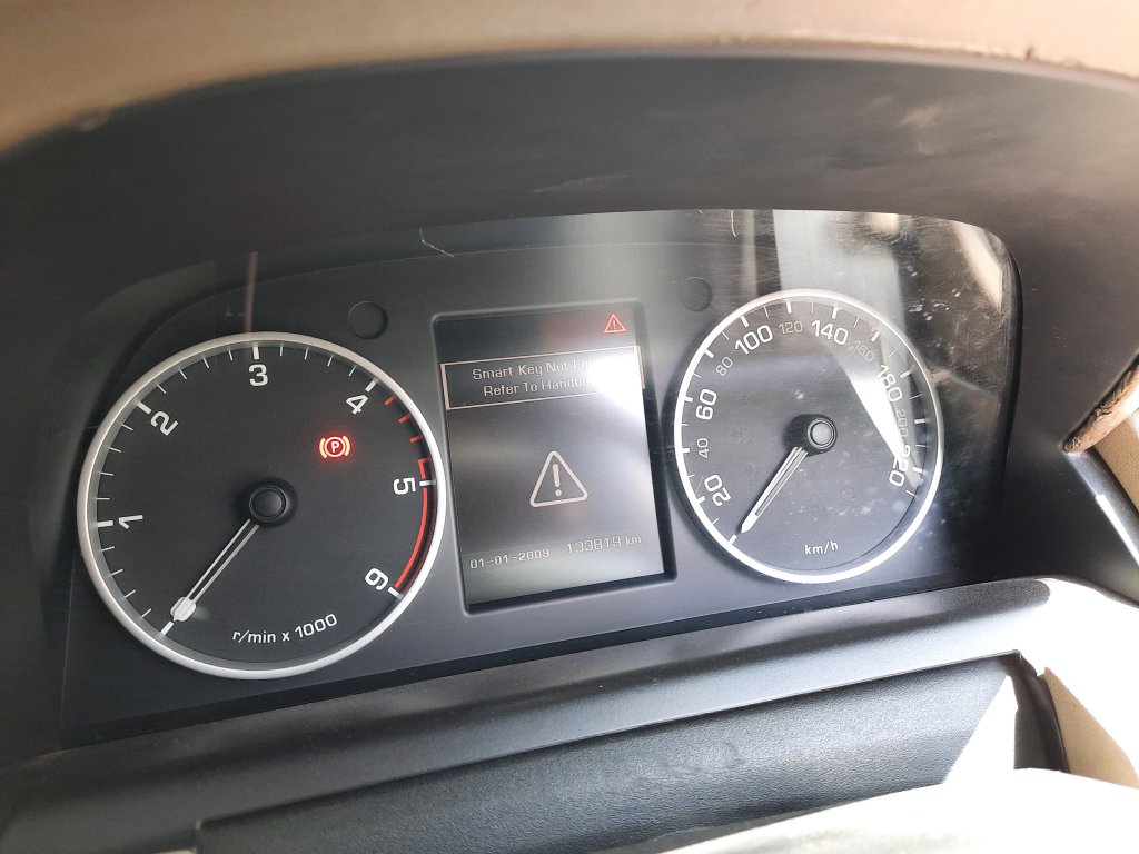

I have problem in the smart key
Error message smart key not found
How to solve the problem?
I need advice
Nechaken
Nov 19, 2017
641
262
Colorado
This looks like a D4 instead of a D5.
That said, I had this happen (in my D4) when the battery in my fob was dying.
To get your car to start in the meantime, hold the fob underneath the steering column while hitting the start button.
