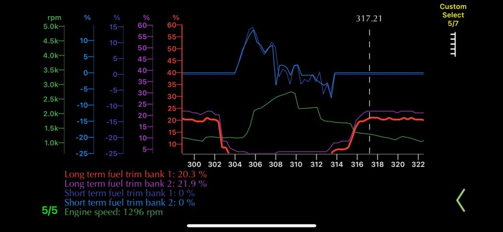

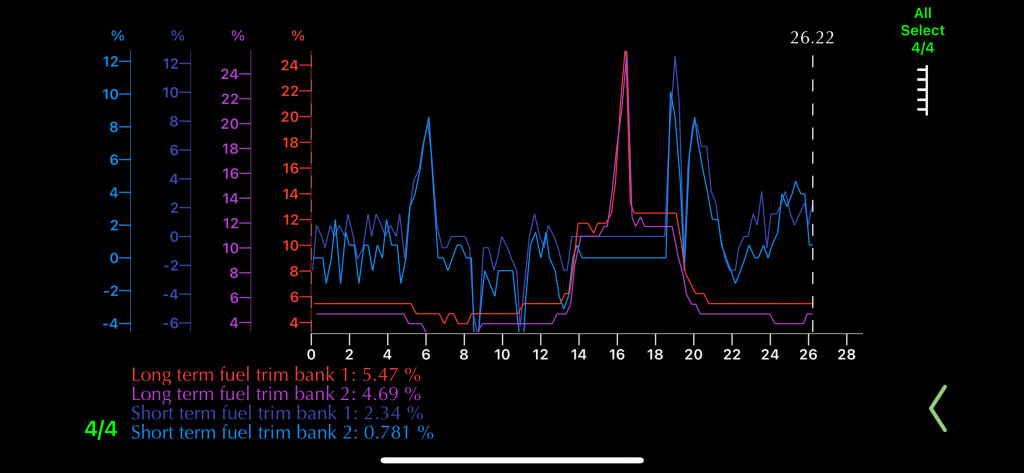

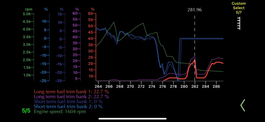

Man, I wish the export feature on the GAP tool worked better. I recorded a fairly lengthy run with a few hard accelerations, monitoring RPM and the fuel trims. Best I can show is the highlights as screen shots.
These first two look "OK" to me, I think. You can see the ramp up in RPM as I put my foot in it, and then there's some adjustment as I basically let off the gas.

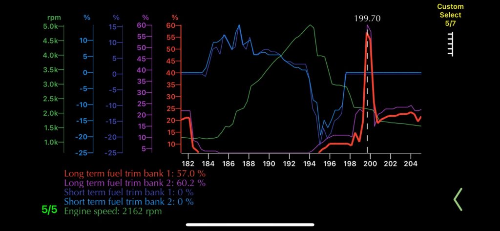

Then, however, I get this one, where the post-acceleration spike is pretty high on both banks 1&2. And yet the two banks seem to be largely tracking one another (NOTE the slight variations in scales at left...another issue I have with the software)
So I don't know if this is normal or not, and I likely won't know whether the P0170 code will return until I take my next long trip.
jlglr4
Mar 19, 2019
1,018
544
Northern California
I’m not 100% on this, but I think fuel trims are not very valuable readings during acceleration/deceleration, only cruising and idle. I believe the car goes into open loop fuel control, so not sure if you can discern anything from the fuel trim readings.
greiswig
Mar 1, 2021
653
274
SW Washington
OK, thank you. Do you have any suggestions for what I should look at to gauge whither cometh this "P0170-00 (27) Fuel trim (bank 1)" that keeps getting triggered? It doesn't seem to affect performance, but it sure doesn't give a guy warm fuzzy feelings to see the engine light come on on the dash.
