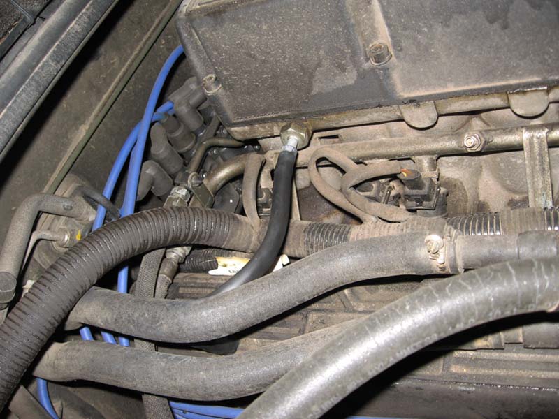

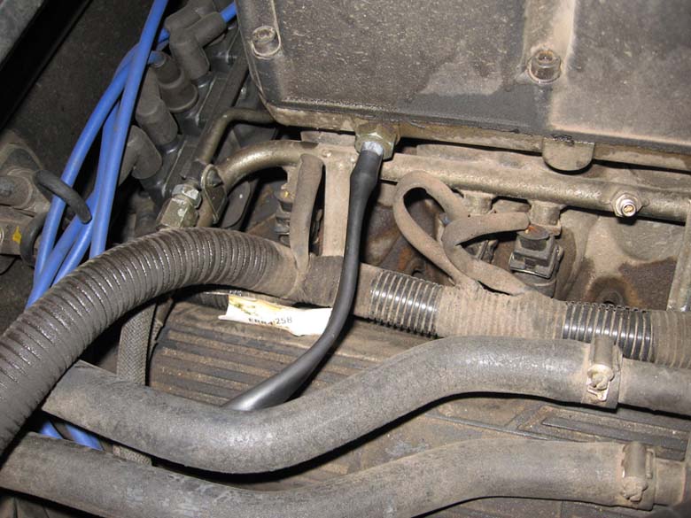

Turns out, I found the problem. It is a vaccum hose comming off the intake. When the motor is running, the hose is sucking shut and making a loud sucking sound. hahahaha
Why would this be doing that?
First pic is with engine off
Second with engine running
It is the cleanest one in the pic :)

Sounds like the PVC valve is clogged. Not a good thing. IIRC you can change that fairly cheap.
but I would still keep my eye on the tensioner (they do tend to go bad).
