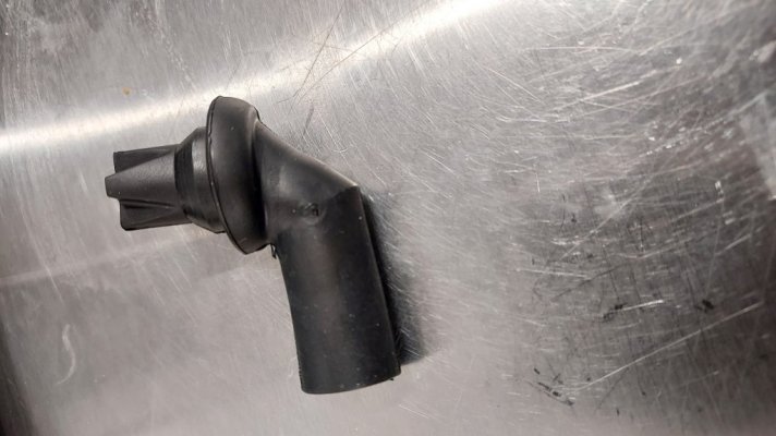

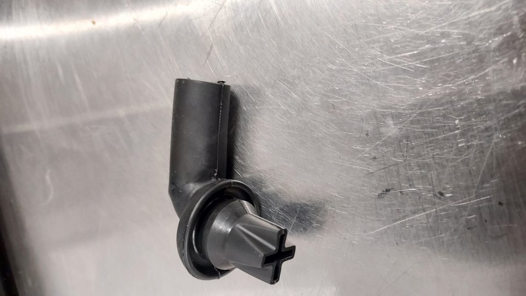

The sunroof drains in the front fender area can be replaced with a VOLVO part. It is a 100% exact fit.
The OEM drains can deteriorate over time and leak.
The VOLVO part # is: 30753148 ( you will need 2)
WAY cheaper than the Land Rover part.

Roverrange: What is the advantage of the Volvo part vs Land Rover OEM?
