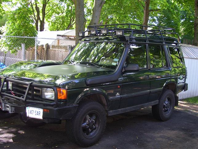

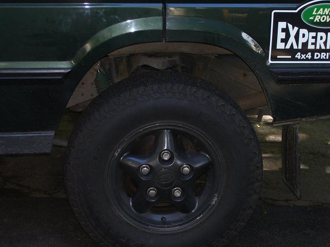

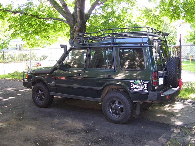

Here's the lift. Gonna change out the rear shocks just to be safe. They do seem a little stretched. Brake lines seem ok. But probally wont know to out on trail. Let me know what you all think. Flame if needed not emotional type of dude. Thanks guys

Looks very nice... you may be a little over the 2 inch mark... or mine is just sagging... :frown:
What size tires are you running? I would suggest the longer brake lines before you go play. Looks at the limit of brake line length.... but then again it may work.

Thanks Joey. Tires are 245/75/16. How do I check the brake line limit length? No wheeling any time some. Work/family schedule is crazy.

Kind of a pain... basically you have to get it to articulate far enough to see if the brake line on one side or the other is at its limits... normally around the 3inch lift mark you need longer brake lines.
