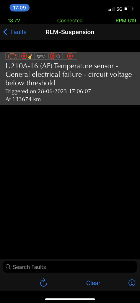

Temperature Sensor - Circuit voltage below threshold
Showed up on my drive home, it'd go away after a bit, then come back up, and then go away, and come back. No restricted mode or anything like that.
I've read that there are issues with the sensor inside the compressor. I have a Hitachi. 2015 LR4, 83k miles. Curious if there's a way to replace just the sensor? Seems like there is more of an electrical issue? Fuse maybe? Open to any insight here...

Spoke with my indy—and they said they've never done one of these before, just replacing the sensor and questioned whether you can even purchase the sensor on it's own. I'd hate to have to replace the compressor just for the sake of the sensor... but will do, if that's what it comes down to.
Any other options people suggest I start with here? Relays? Etc?

After more research and diagnoses, it seems like it's an electrical fault and the wire that connects the sensor is corroded or shorted. The fault will show up by just turning the ignition on (not engine), which is a direct indication that it's an electrical fault. The code provides that clarity too. Will need to track down where the issue might be now.

It ended up being the temperature sensor that's connected to the compressor. BUT, when I tried to replace the temp sensor, it cleared the code, but then threw a SOLVED. C1A27-12 - Compressor Circuit - Circuit Short to Battery code, think I might've shorted the relay. But, when I tried a different relay, I still got the code. Luckily, I'd ordered a new compressor to have for a rainy day—turns out that was the rainy day. Ended up replacing the whole unit, and all is well.
