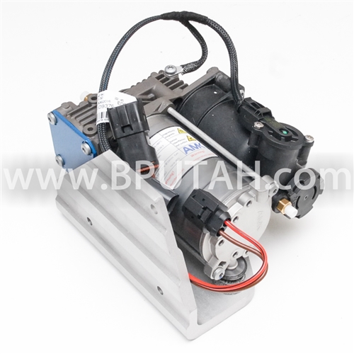

If you want to know what wiring connection I'm talking about, the exhaust valve is the part right above the "H.c" in the watermark in this photo, and the wiring connection that was unplugged on mine was the wiring leading to it:
No idea how it came unplugged. I guess it wasn't fully plugged in when it was installed in August 2018, and took this long to work its way unplugged? Who knows. Imma going to go grab a taco.
