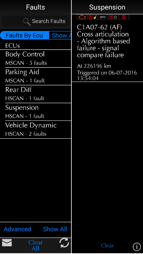

Does anybody know anything about this code? I get this almost everytimg I drive. Red fault suspension lowers. Sometimes goes away quick on its own, others i have to reset. Is this software related?

You have an issue with your EAS calibration. This could be due to a bad sensor, a lost calibration, a severed wire harness...or a combination of these things.
It's not terribly hard to fix. I'd even say it's a DIY job if you have the time and an IIDTool (or equivalent). Sensors aren't all that expensive, it's figuring out which one is toasted that may be tough. Do you have the 4x4 Info screen on your LR3?

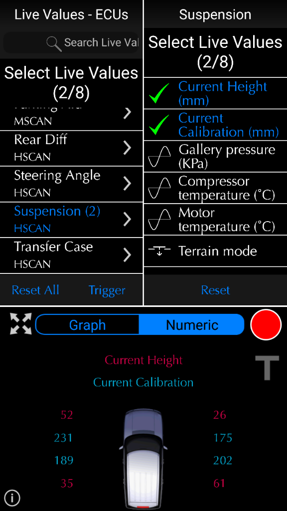

I do have the GAP tool. I probably messed it up myself as I did quite abit of adjustments when I first got the tool (around the time the problem started occurring) I modified the height then adjusted a corner that was quite off. Good news is I actually have a set of 4 new height sensors already.

I had this one once upon a time. All sensors and wiring were good so as a last ditch effort I re-flashed the EAS ECU software with my faultmate and it went away never to be seen again.

I will address the EAS portion first: GAP recently put out a handy Excel spreadsheet that makes calibrating the sensors pretty easy. I would just step through a full 4-corner calibration. You can look at the live values and see which one is out-of-range, too. It doesn't necessarily mean that the sensor is bad, especially since it start faulting right after you started dicking around with the calibration values. There is a max/min and if you are outside that window the EAS barfs.

I did the calibration and havent had the fault happen again yet. I havent done too much driving since, but time will tell... fingers crossed.

If you've driven over 60 mph since then, I think you're in the clear...that's the speed threshold for cross-articulation faults....I think. At least you know WHY it lost its calibration (i.e., you messing with it) so there is no mystery there and likely no hardware required...AND, you learned how to do a 4-corner calibration.
