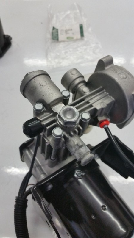

You may still have a leak/blockage and so the compressor is protecting itself - I think there's a temp sensor in there somewhere on the Hitachi pump. If you have cleaned up the filter and the media and you're sure you don't have a leak, may be worth spending about $25 on the refurb kit which is new O ring(s), spring(s) and a new valve for the compressor.
L8RSK8R
Aug 20, 2014
There is a temp sensor. Little black boot on left of pump pictured.

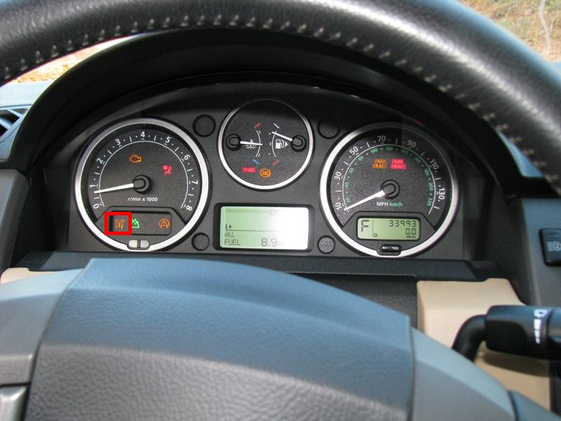

Brother just took off to on two hour trip, now he's getting warning light on far left of message center. He hasn't adjusted suspension settings.

Remove the temp sensor it should just unscrew and hold it away from the housing and see if it helps also do a continuity check maybe it has. Melted due to intense overheat.
