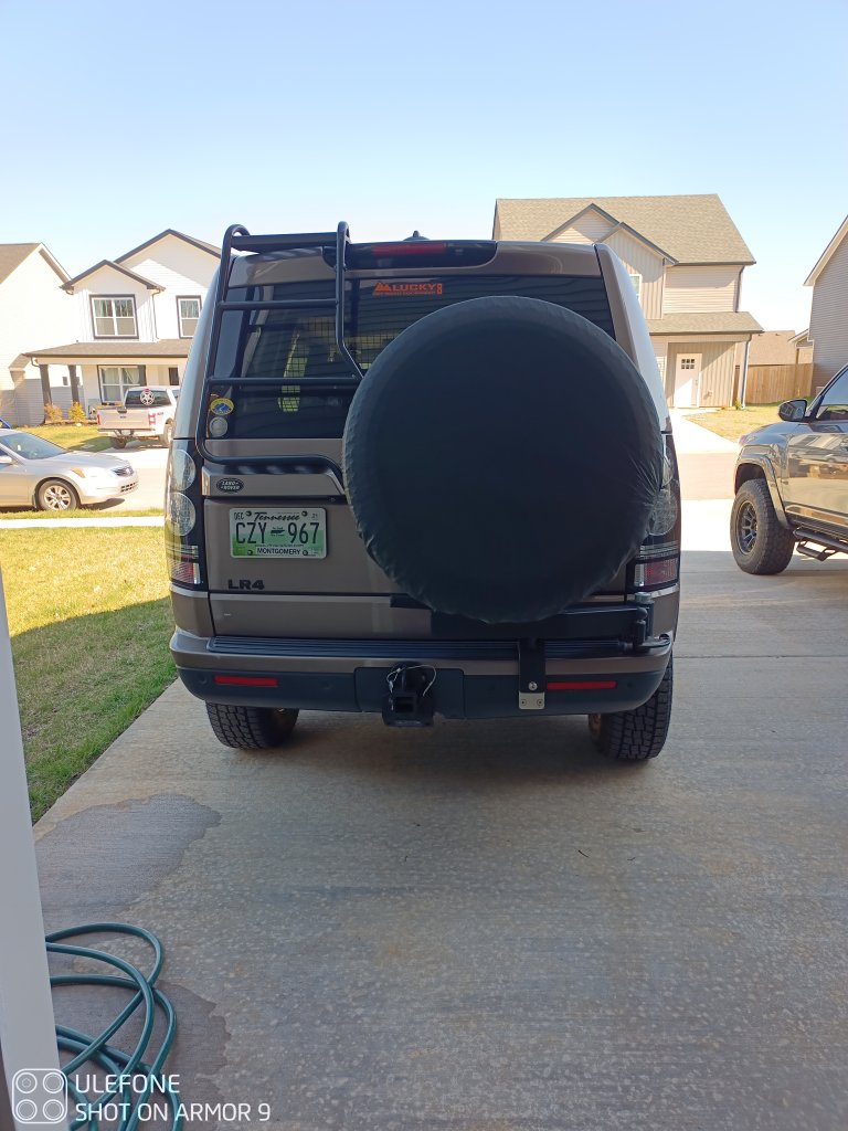

And how is Rasta working for you, @ishapiro?
Have you looked at the rijidij off-road carrier? It was solid with no rattles and had a great locking mechanism
