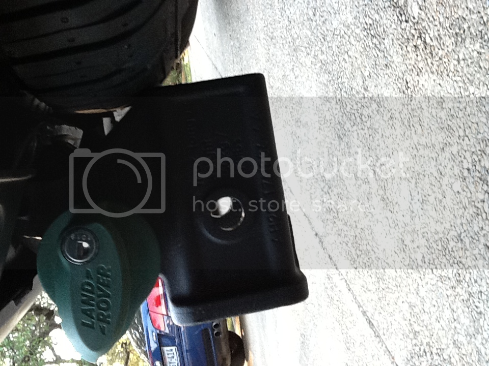

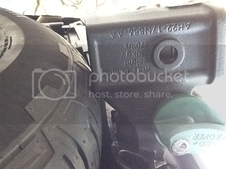

I promise, I am NOT making this up ... Do you guys have the other (longer) version of the hitch receiver???
Forgive me for not rotating these pics ...
baobay
Jan 2, 2011
667
Doesn't look right with the spare right against the hitch!
crewcabrob
Jul 8, 2010
606
your spare tire is hanging too low. My guess is that it's not up all the way.
Rob
baobay
Jan 2, 2011
667
I agree. It does appear that the spare is not stowed properly and is hanging too low.
dipan
Apr 11, 2011
37
Thanks guys, I will double check it ... This seems like a reasonable reason as to why the hitch wouldn't seat the first time I tried and tried ...
