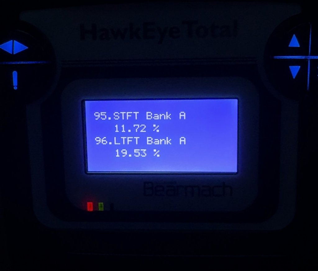

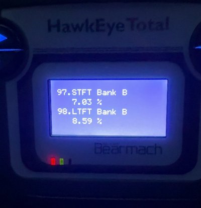

You seem to have a code reader - can you check fuel trims? Also, you might take a look at your throttle body - see if there’s any gunk that might be causing the butterfly valve to hang up.

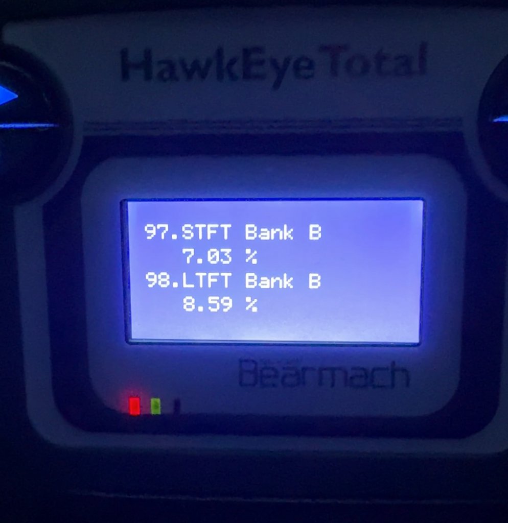

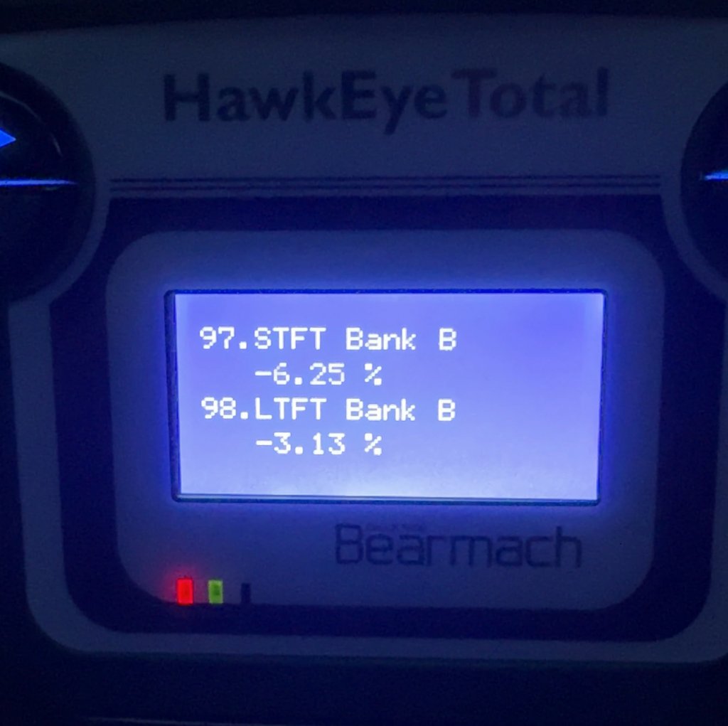

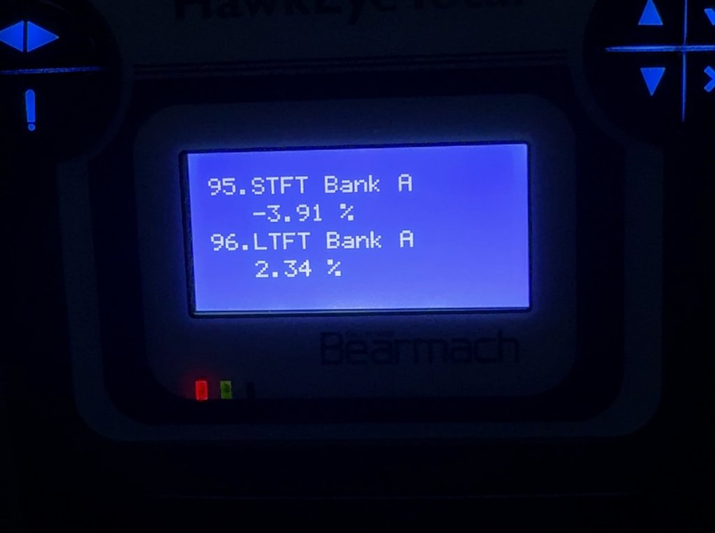

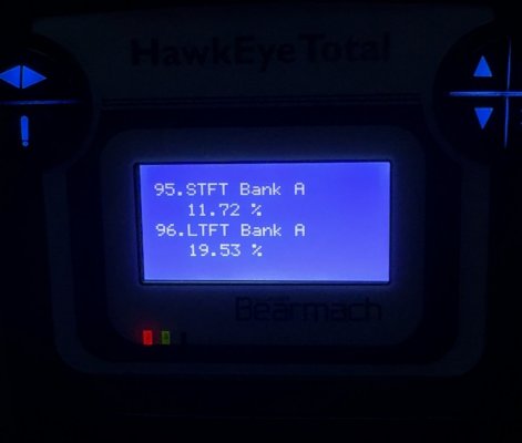

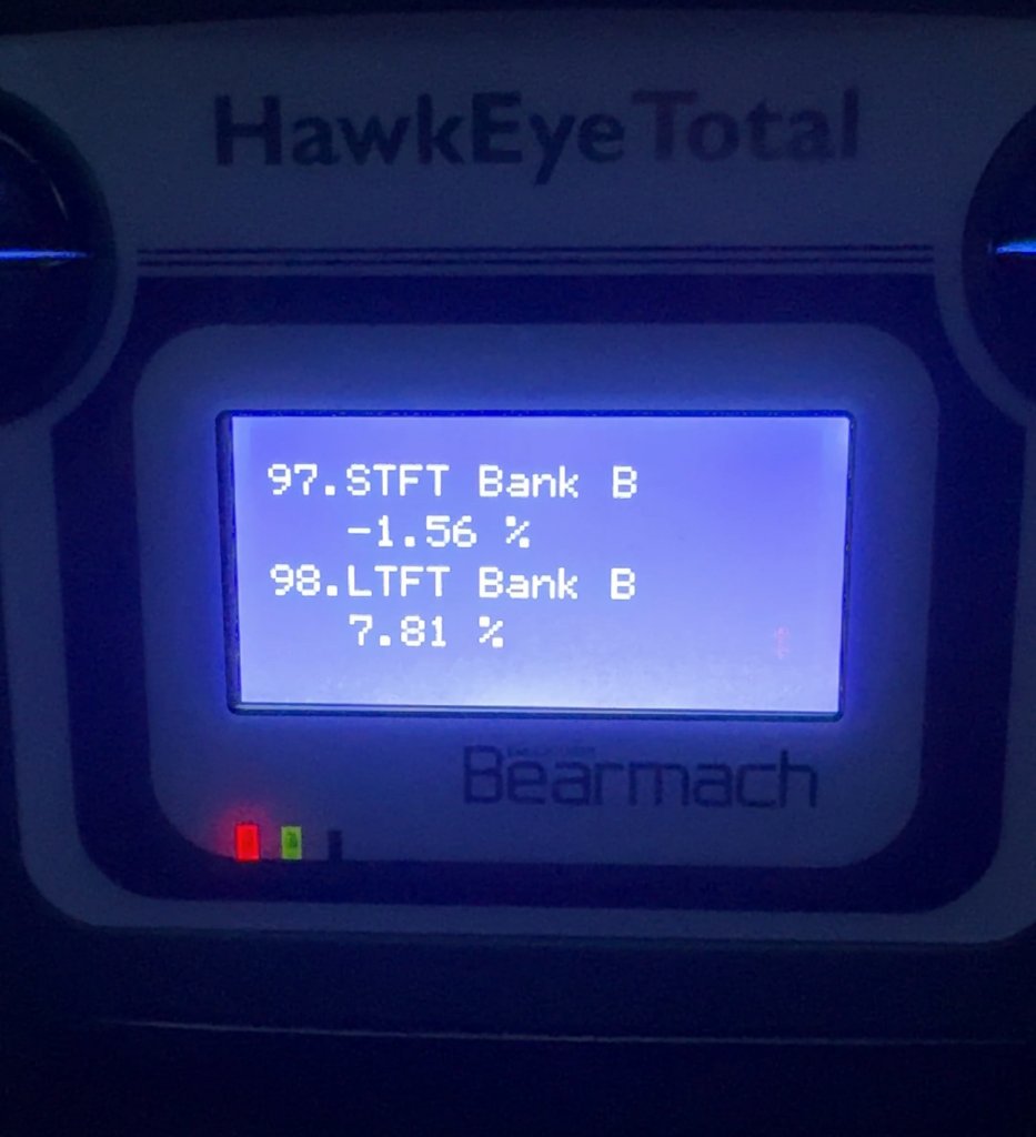

Posting fuel trims, if the photos upload in the correct order… they’re ordered idle, 2200 rpms, then back at idle.
Definitely something going on there. I’m guessing I’ll start by ordering o2 sensors and checking for vacuum leaks.

RossN1999
Aug 22, 2014
19
7

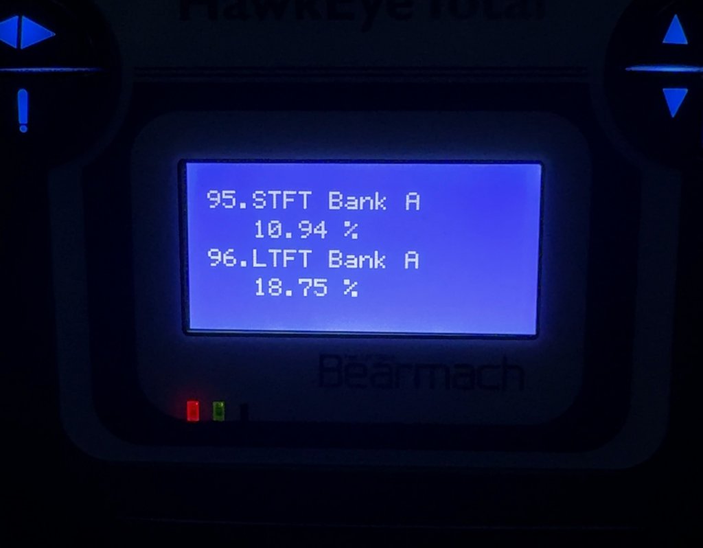

This is the last photo that didn’t upload, this was idle after the rpms were up.

Update: After changing my transmission fluid and filter the issue improved by 90%. Occasionally it will still do it but much less severely and much less often.
renli3d
Jun 9, 2022
14
14
Seattle
Thanks for the update. Your fuel trims are poor though so you need to figure that out. I'm thinking vacuum leak as the most likely culprit.
