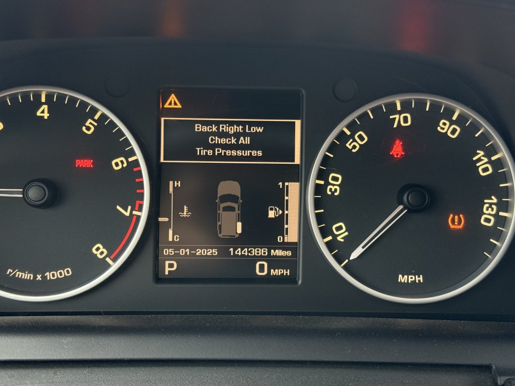

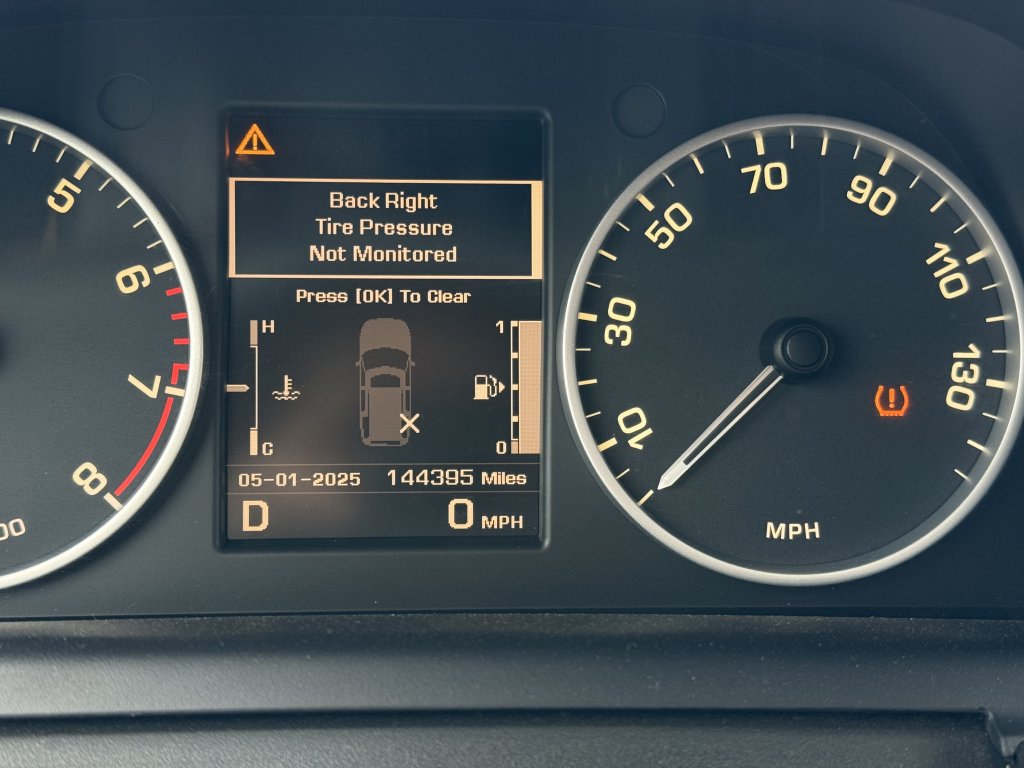

For context I picked up two large screws in one of my fairly new KO2s yesterday and as a result I swapped in my 5th wheel while the shop replaced my tire. The 5th wheel did not have a TPMS sensor but the other 4 do. As expected driving this way triggered the system saying the tire was low and then not detected.

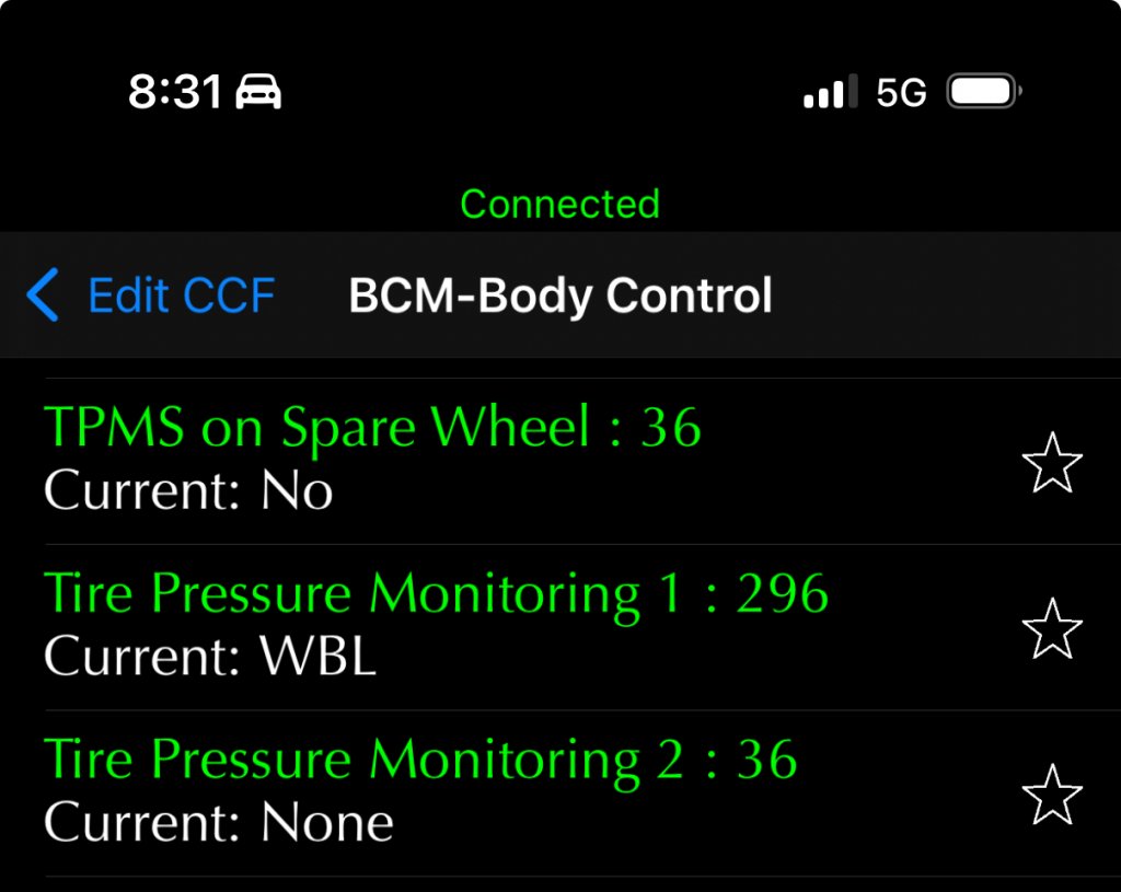

I used my IID tool to disable the TPMS, but I am still getting the tire pressure warning despite the CCF being updated.
Is there another setting I need to change? I followed the guidance from GAP directly.
