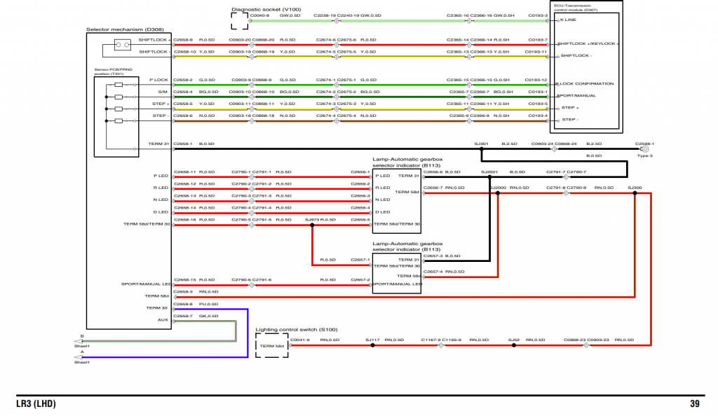

ok great I am having my local seattle electronics shop do the same. My concern was how to find a like connector otherwise I would have to get a generic one and wire up the plug which would just add more time.
By the way there are two wires that are yellow on the wire bundle one is for shift unlock and one is for manual + shift signal. So those I am basically having to guess which pin it goes to, and just try both ways. Will let you know how that turns out once I get my repaired assembly back.
