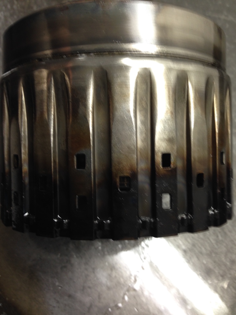

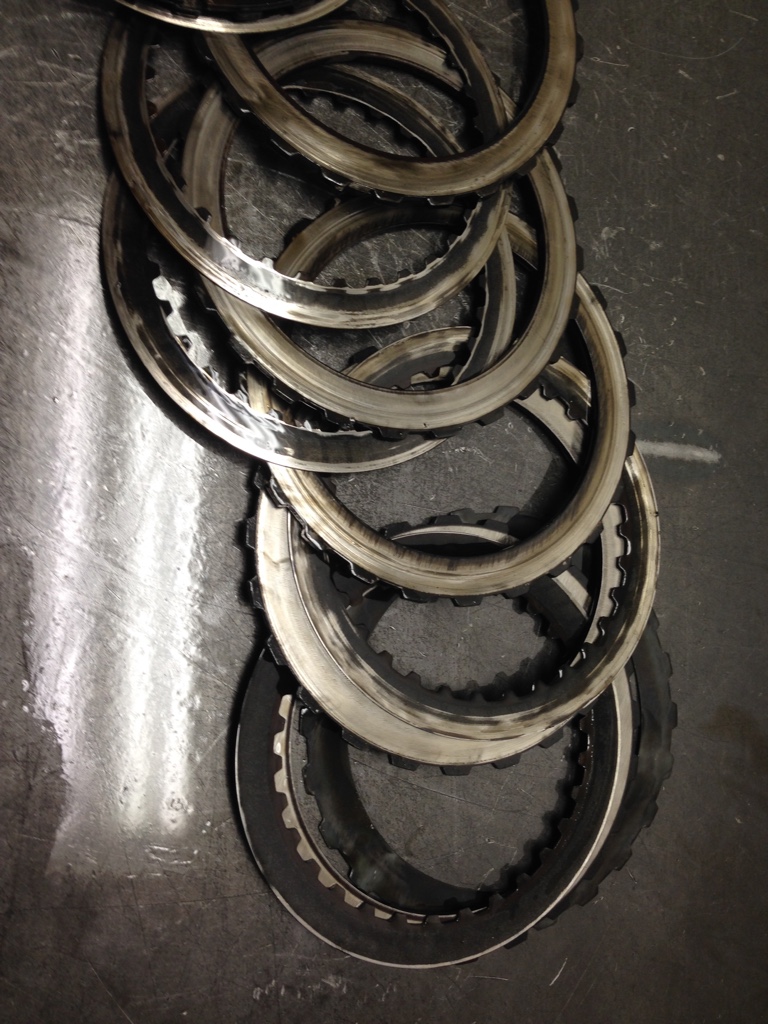

no-pistons
Aug 20, 2012
35
Same thing happened to mine. The transmission will most likely need to be rebuilt or replaced. The E-clutch had burned up
