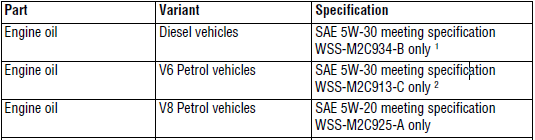

I was wrong here, and I can't seem to edit my post, so I'm coming back to this because I realized in the Owner's Manual it says:
Then at the bottom of this table, footnotes 1+2 are:
So,
Diesel D4 = SAE 5W-30 WSS-M2C934-B or ACEA C2
SCV6 D4 = SAE 5W-30 WSS-M2C913-C or ACEA A3/B3
V8 D4 = SAE 5W-20 WSS-M2C925-A

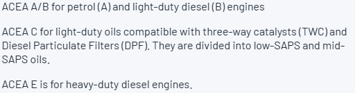

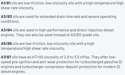

ACEA codelogic for reference:
