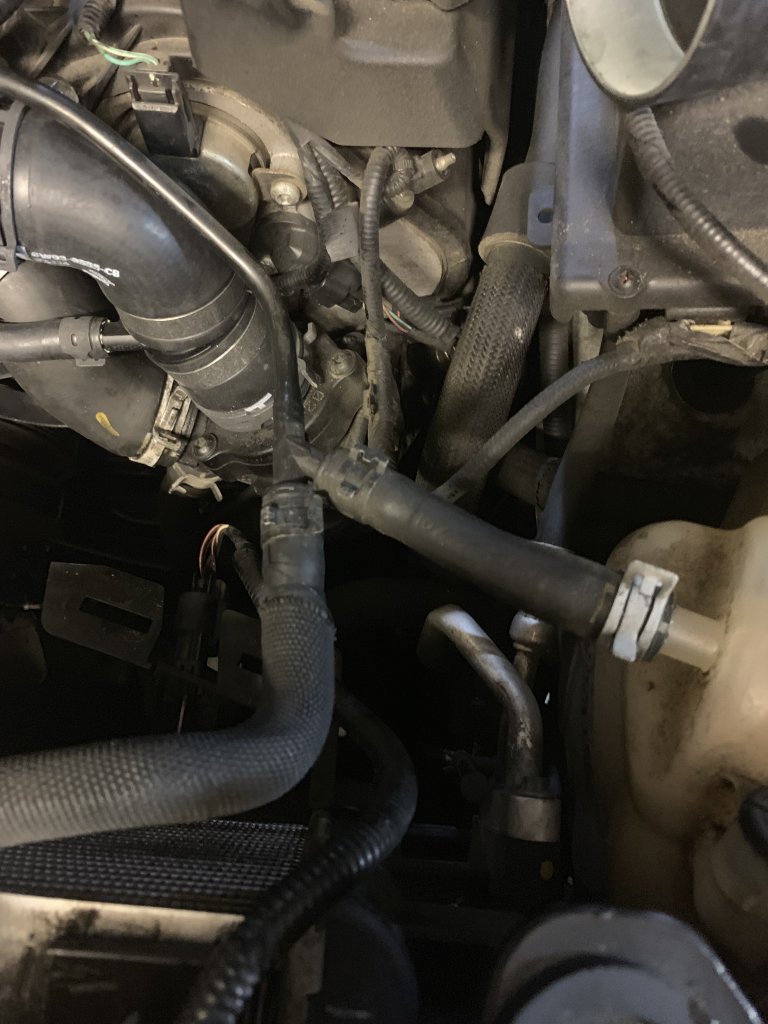

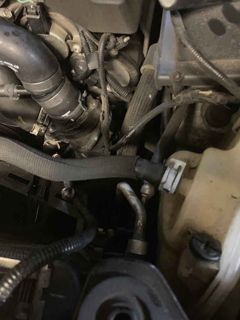

Also can anyone explain the modification with the new hose to thermostat? There’s the new dummy line coming off the throttle body, and I assume the tube coming from the overflow tank gets attached to the other side of the dummy hose? My main question is why not just provide two end caps? One for the throttle body and 1 elbow for the overflow, it seems way more complex than it needs to be. Is this just me or am I missing something?

So photo above is original photo 2 is my simplified version... is this an oversimplification?
