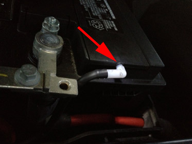

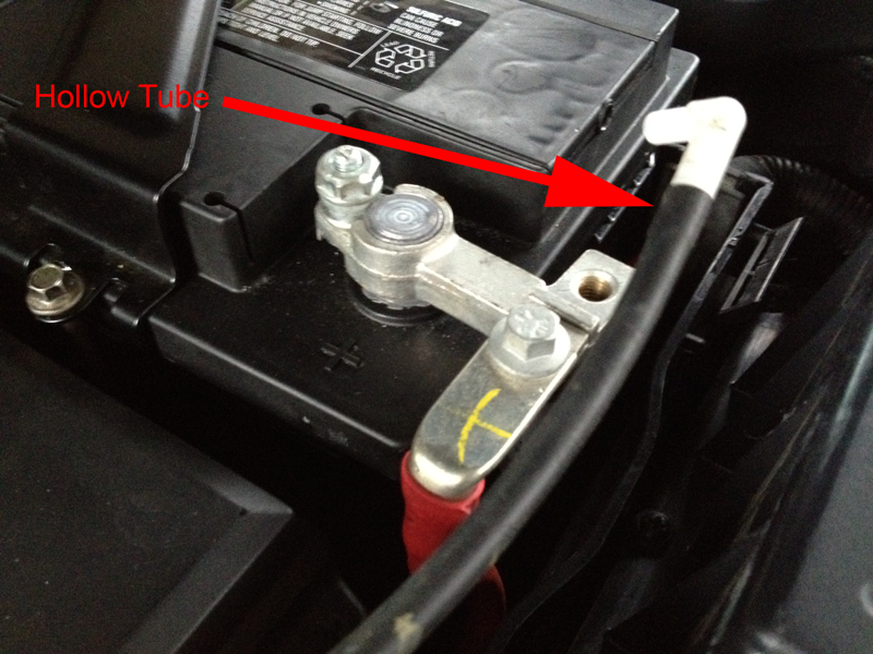

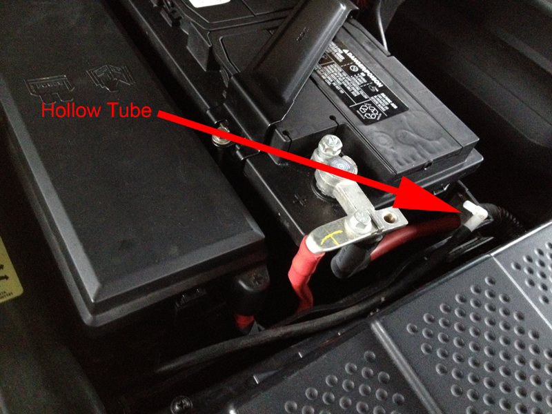

I was checking out my battery area in LR3 2005 looking for Transmission ECU but discovered a detached hollow tube running from around the fusebox not connected to anything . Do you know what that is? Look at the attached pics. Is this how it's supposed to be or is it missing some connection somewhere?
Thanks for your help in advance.

Ah, it was battery overflow drain. Attached!

Yep. Some batteries require distilled water or other fluids in order to operate.
tlt
Mar 31, 2011
727
It is the battery vent tube. It is not always used, as some batteries do not have a vent.

Wet-cell batteries sometimes use them. If anyone uses an Optima Yellowtop battery, is it worth all the money? My current battery is fine, but plan on changing soon.

Check both sides of the battery for a vent. I had a battery vent tube become clogged and it ruined the 4x4 control unit. It took three months and two grand to fix it. The battery can boil and spill acid directly onto the control unit.
