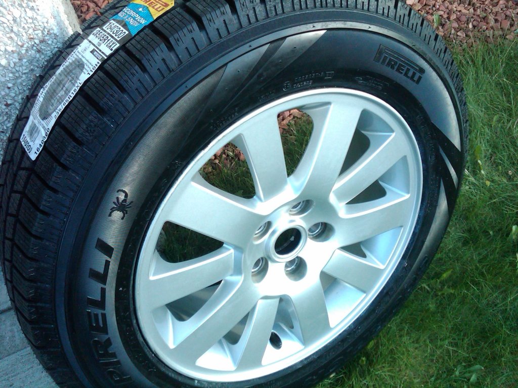

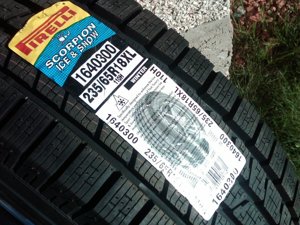

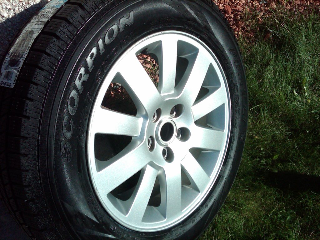

I am running Pirelli Ice and Snow 235 65 R18 XL 110H on my 18" Land Rover ten spoke rims for my winter tyres; Bridgestone Dueler Alenza HL 255 55 R19 11V XL for summer on my six spoke 19" rims.
Note for winter, that I used narrower taller rubber, but on 18", not 19" as I think you are looking for.
The 18" Pirelli's seem to work for me - had them on since the winter of 2012.
