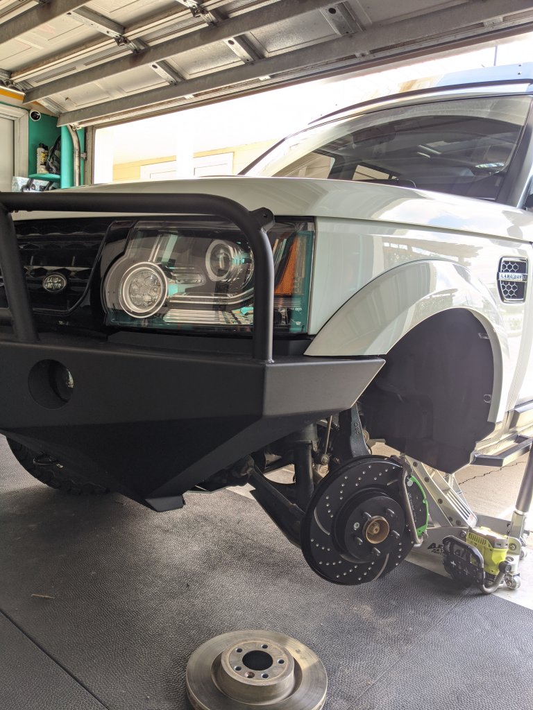

Just replaced mine with EBC rotors and pads...and the sensor. Pretty damn easy. My suggestion is to make sure you have a breaker bar, a slim 17mm wrench (needs to be slim) and something to push the caliper pistons down. I bought a 5 dollar compression tool at advanced auto. Also take a look at all the hardware first (screws/bolts ) to see if anything needs replaced. I watched the video from powerfulUK first just to make sure I was doing it right. I love the brakes and rotors. So far so good.
