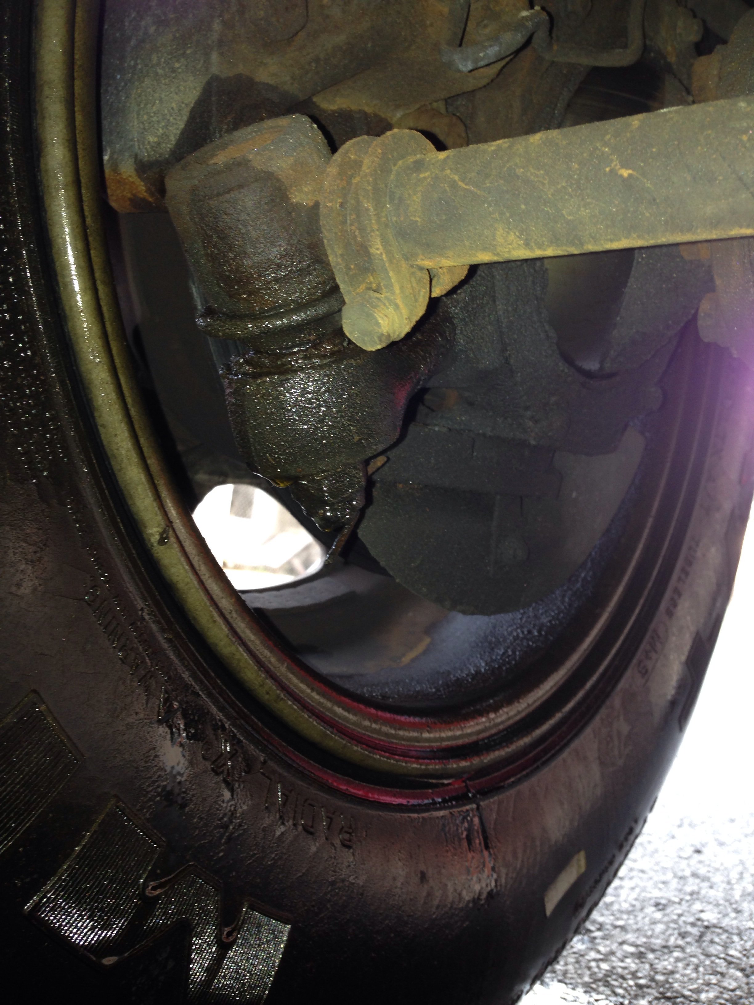

Okay update! I put in some brake fluid. The same as told in the manual. I too it for a drive around the block. Here's what I noticed. Since I put the fluid in, I seem to get some braking abilities in reverse. In drive, if I press all the to the floor, I can time stops. I also notice this, there is a leak on the wheel itself. It's leaking a fluid, same smell and color as the brake fluod I put in. The leak is on the inside of the wheel. It splattered while I was driving onto the tire. The brake fluid reservoir is back to the min line. Okay you all what does this mean? image.jpg
It means you have a bad leak at that wheel, either the line is rusted through or the caliper is leaking. Either way you will have to pull the wheel and tear into things to see more.

Easy way to check the leak is first (brake fluid) and not axle grease, is to (if you are by yourself) dry the inside of the wheel hub and caliper cylinder along with the brake lines.
Get a new clean dry paper towel place them inside the wheel area under where the dampness was occurring most.
Fill the master cylinder and start the engine and pump the brakes a lot. A leak that bad will drip on the paper towel and you will know its fresh because its on the new paper towel. Then you have to figure out if its a hose or caliper seal.
Ya a shiny tire on the inside usually is a seal gone bad most times.
