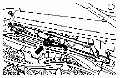

Windshield Wiper Motor
Removal
Remove the plenum chamber panel.
Remove the windshield wiper motor and linkage.
Remove the 2 bolts.
Remove the 2 clips.
Disconnect the electrical connector.
