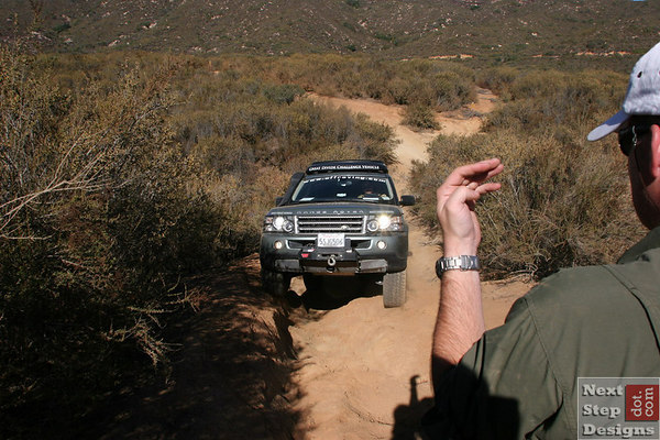

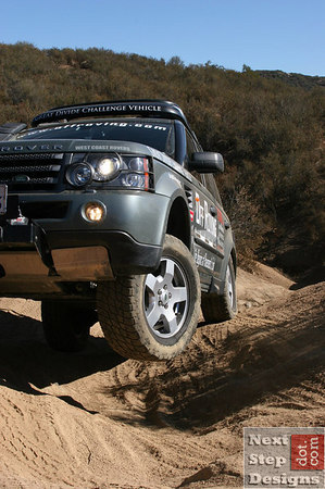

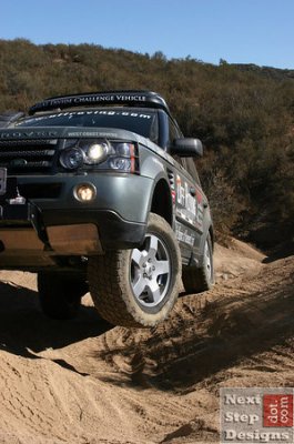

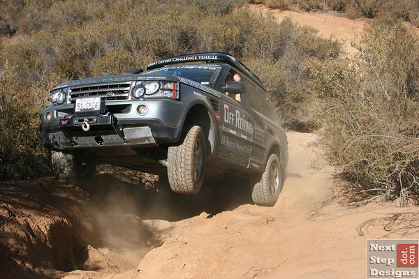

If you can find yourself a nice little V-ditch, use it to practise engaging the TC system, like we are doing in the photos below in our "Dipped in Green" training sessions through www.OffRoving.com
