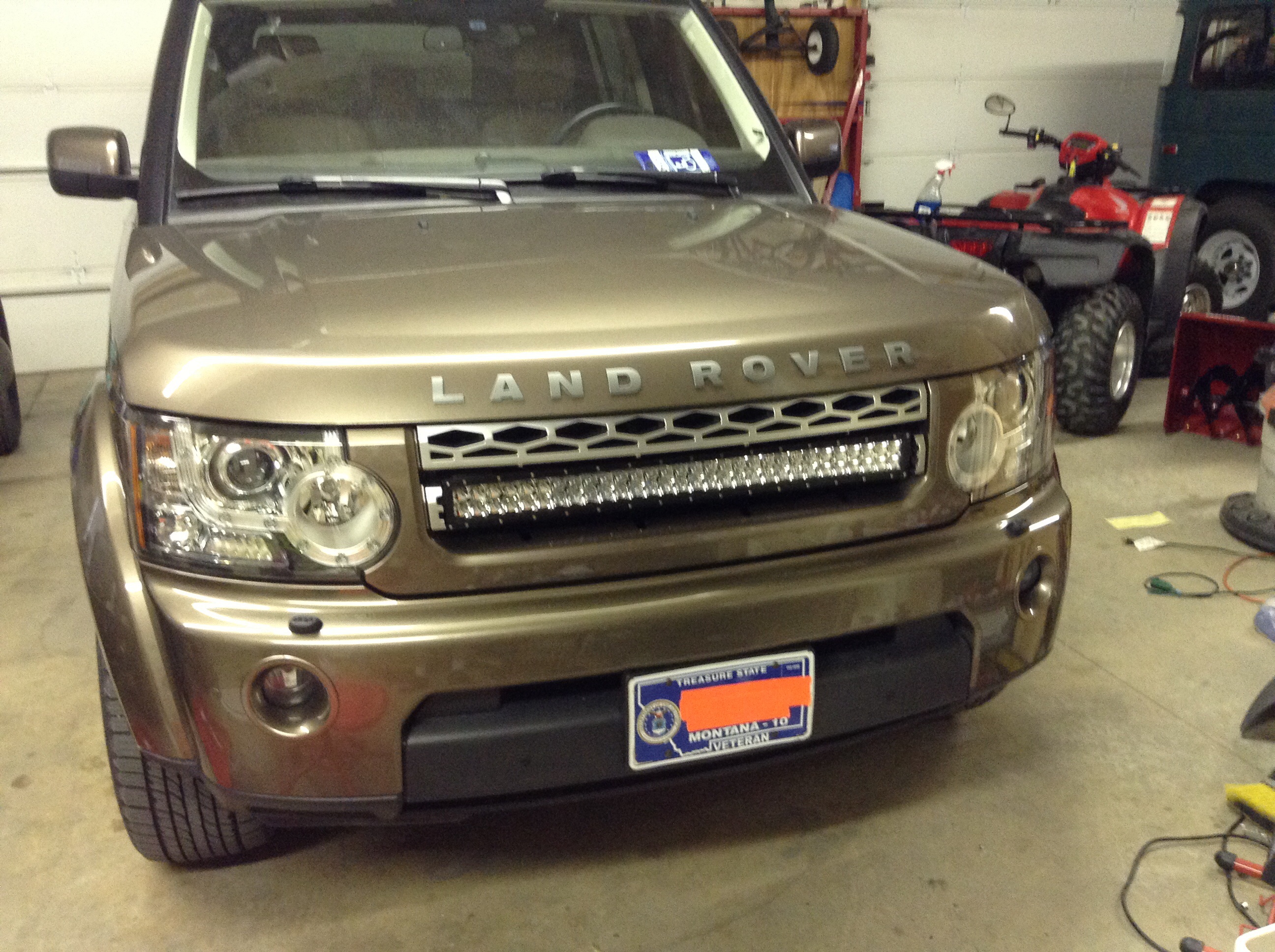

Here you go. Mounted 30" in front grill and no shaking, recessed to keep it looking like its part of the vehicle, and only $275 thru Amazon. It's a tuff stuff lightbar. I compared it with the rigid (I bought both) and quality and performance were the same. My light meter showed a negligible increase in output by the rigid. Certainly not worth the almost four times more per bar cost.
Driving is vastly increased. 99 percent of the roads around Montana have no lights. Not any more!

So what is the difference between the tuff stuff and rigid then?
