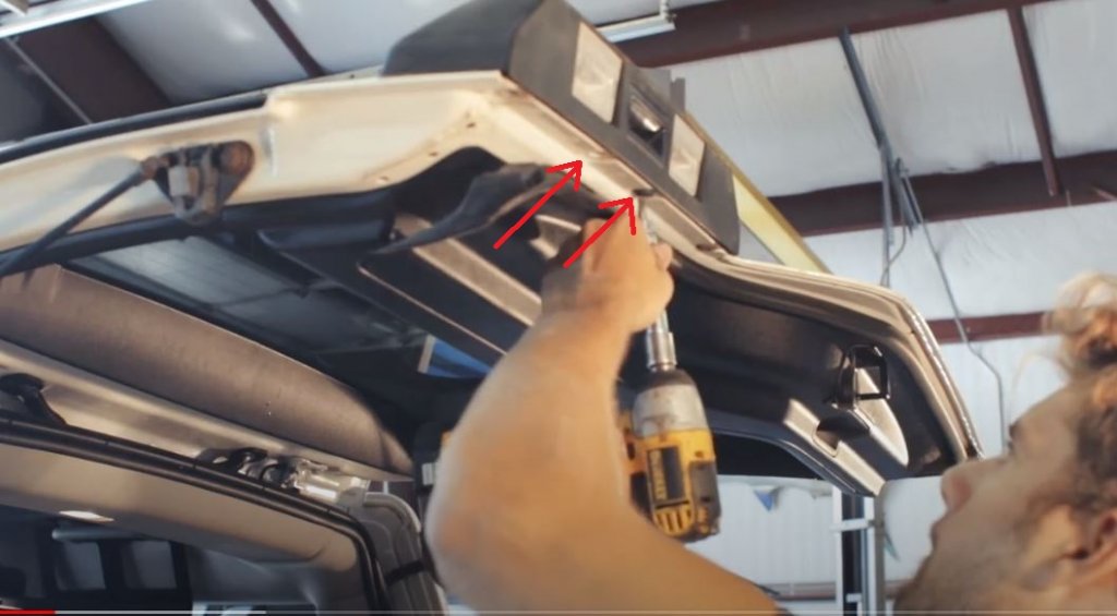

I went to install a new Frontrunner rear ladder on my LR4 and ran into a snag. The two center bolts that attach the rear lift handle just spin. I think they rusted/seized into the handle with the nuts dislodging. I am guessing that my only option is to drill them out. Any thoughts?

Can you get a pry tool under the bolt heads so you can apply some pressure as the drill tries to back them out?
Agreed. If that doesn't work, visegrip and let rotate until it rests on something to prevent rotation.

I had to do almost the exact same thing except I used needle nose pliers. It just took adding a tiny bit of resistance to get it loose.

Those bolts go into nutserts in the rear tailgate handle. They lose their bite in the plastic over time and then spin. I ended up replacing my whole handle recently (and my car is only 2015!).

I've got a FrontRunner ladder and it's been rust free so far, but I do agree that the mounting design isn't not optimal - those nutserts were never designed to take this sort of load.
