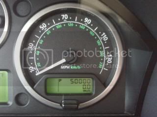

Last week was a milestone. The factory warranty expired at 50K miles, just a few weeks shy of 4 years of ownership.
Just finished the final service visit under warranty, and thought it would be a good idea to share. There were several common LR3 issues, and some not-so-common problems to look for. Thought it would be a good idea to list them here for other owners who are approaching this milestone.
