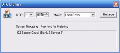

Here is what that is....
Passenger Side front O2
