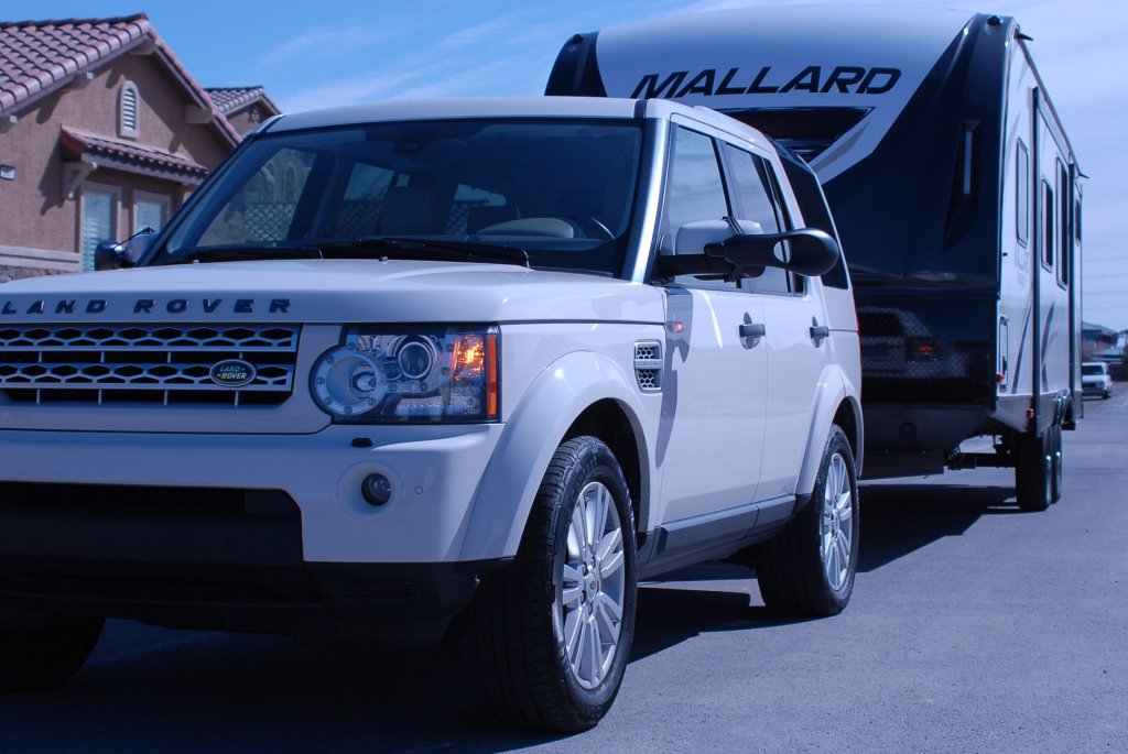

Hello,
I'm a new member here and recently got 10 LR4 with 100,000 miles on. After through research, I concluded that LR4 is a good tow vehicle. So, I pulled my 6,700 lbs Heartland 32 ft travel trailer to a near by state park yesterday. It was good start. Air Suspension worked beautifully. Tow Icon comes on and works fine, it seems. Plenty of power. Not much sway. I used Manual and Sports Mode gear shift to make sure it got enough power.
Here come the question: After one hour of driving, it jerks couple of time to find right gear between 3 and 4, Transmission Fault Yellow warning on :( Then, it seems Tranny locks in 3rd gear only. I hardly reached campground in "limp mode". Once the engine is off. It goes back to normal. Unhooking the trailer, and driving without a trailer, tranny is very smooth and no issue. Next day, on the way back, it happens again. I was manually shifting between 2nd -4th gear on hilly road. I tried maintain 2500 to 3000 RPM all the time. But, Transmission Fault warning.
Can anyone tell me what could be a problem? Do I need to scan the code first, would I need new transmission? Thank you.

Does Huy's issue seem to be the same as yours? I would hate to de-commission the rover without a definitive diagnosis..
Damn fine rig..

Pfunk951 / There are some similarities of the symptoms. I'm still not sure about if the tranny temperature went up abnormally high, though. Because if the temperature was an issue, it should have displayed 'transmission fault due to high temperature' warning, not just 'transmission fault'. I guess I have to try oil change first and go from there.
Surely, the set up looks great, to me. I wish it worked as good as it looks.
