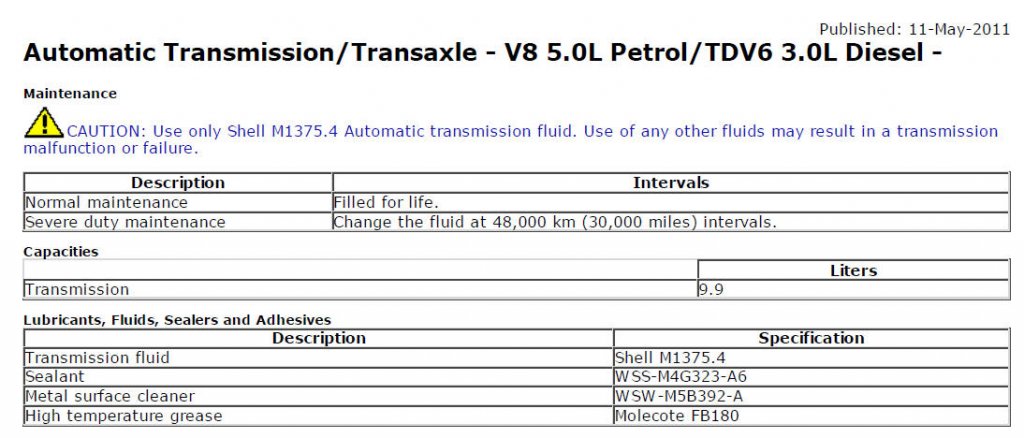

ZF is the manufacturer of our transmissions. They call for fluid/filter changes at 60k. Land rover calls for one at 120k (I think) and some LR techs will tell you they are filled for life.
LR documentation has conflicting info. The owner's manual says to change ATF at 120kmi, while the service manual says "filled for life" under normal service, or change at 30kmi for severe service (i.e., any towing use). Screen shot attached below from service manual.
Given that the transmission fluid cannot be completely drained (there is no drain plug on the torque converter) and over half the fluid remains after draining, IMO it would be smart to change the fluid every ~30kmi regardless of if it sees normal or severe service. At least then it's getting almost half new fluid on a regular basis. Dropping the pan to clean it and replace the filter could likely get pushed out to a longer interval with normal service; the fluid change is relatively easy, the filter change is not.
