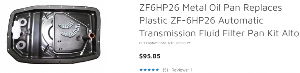

I found another that might work, but specifies it's for a ZF6HP26 transmission, when mine is the ZF6HP28 [078BS]. Do you guys know if this pan/filter will work for the 28 transmission? https://www.oregonperformancetransmission.com/product/NTP-K79600M.html

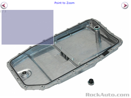

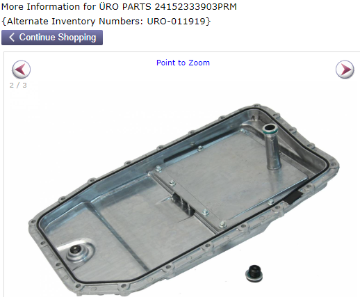

Rock Auto doesn't seem to have one that is split, except for this one below, filter bolted to the pan ÜRO PARTS 24152333903PRM, but I don't want to have to jack up the engine to get it in.

On the OPT web site:
*This application could have had either the 6HP26 or HP28 version transmission. This pan only works on the 6HP26 transmission.

Yeah I read that, which is why it's confusing - the last sentence contradicts the first half. Plus this pan and bolt orientation looks identical to the Atlantic British part I posted originally.
Here is another one for sale that says it fits both the 26 and 28: https://www.transmissionpartsdistri...ion-filter-metal-pan-kit-aftermarket-fits-02/.
Was hoping someone had a known good source to the newer style pan before I drop the old one down and saw off the filter tube.
