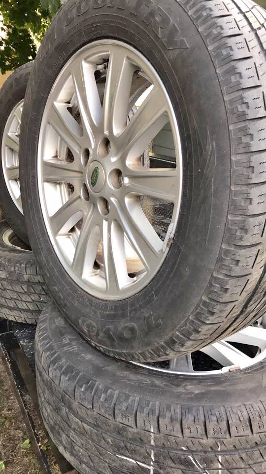

Yeah that's my concern, I have a LR3. It would be a 2 hour drive to go see them and it wouldn't be the greatest fun to burn up precious weekend time for the wrong rims. I stole the picture from the listing to see if that helps?

Yeah that's my concern, I have a LR3. It would be a 2 hour drive to go see them and it wouldn't be the greatest fun to burn up precious weekend time for the wrong rims. I stole the picture from the listing to see if that helps?View attachment 8265
Those look like LR3 rims. Ask the seller what vehicle they are from. I'm sure it's someone with an LR3 who wanted dubs.
I did ask and they've come back with being from a 2008 LR3, which would be really good for me since that what I have. People don't always know for sure though, someone sold me BMW X5 rims that weren't from an X5 at all. I'm new to the modern Rover world and was actually surprised to find that D2 rims wouldn't fit a LR3.
