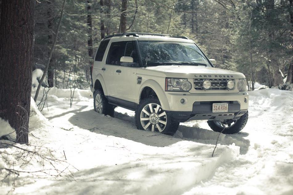

I have the toyo muds on 20" rims. Only taken them out a few times. The only reason I went 20" was that replacement rims ( the set I initially bought) are cheap and plentiful. I won't air them down below 15psi, otherwise they have been okay so far.
Which wheels are those?
Have you gone through any real rocky terrain?
The cheap and plentiful is the thought process I had as well in terms of getting another one if one gets messed up. You can go on ebay and pick most designs up for $200 or less a wheel.
Would the extra 3/4" of tire be nice, yes, little more cushion but we are going with larger tires anyways and so there will be some more cushion there.

Yes, they've seen some rocks. I think the biggest risk is blowing a bead with a 20" rim. The ones I have are off a 2010 RR. I can look around for the part number. I have a 1" spacer on as well, otherwise the 31.9" would not clear the upper arm without it.
Well this is interesting to know. I would have thought things would have been fine with a RR wheel. If I have to run a spacer to run the 31.9" tire then that defeats the purpose in my mind. I might as well just run the 18" wheels with spacers.
This was good information and is turning me away from the 20" wheels.
