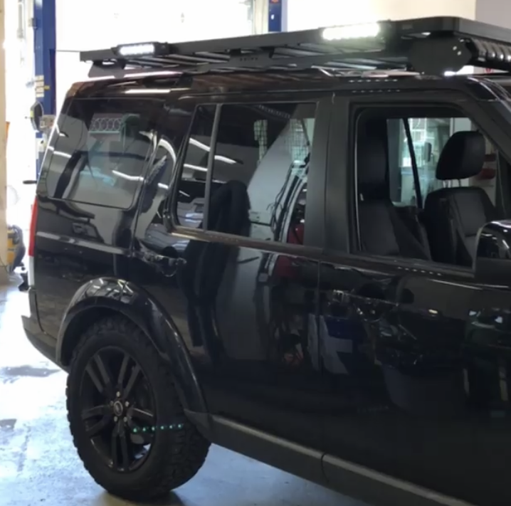

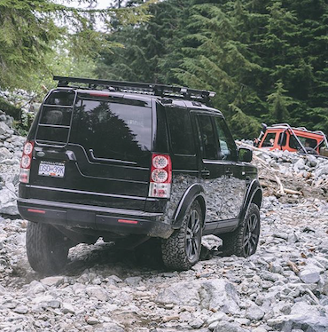

For your 20's, 275/55/20 KO2's. Slight modifications to the left front wheel well
to avoid rubbing needed most likely.

Hey 2011LR4LUXAA,
Any chance you could share some photos of the 265/50/20 Ridge Grapplers on your truck?
View attachment 9743 View attachment 9744
For this 275 55 20 size, you didn't have to do any mods except the wheel well minor ones? Also no lift rods? I was looking at this size and it was unclear whether they rubbed a little or a lot, on a stock LR4.
