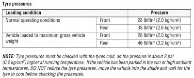

4 every time i go over bumps feels like the tires have too much air pressure but i checked them 28psi FT 46psi Rear probably the cheap tires

4 = 46 in the rear that is a lot. I run 40 all the way around, but depends on tires.

4 owner's manual says to put 46 on rear but ill try 40

The only way your manual says 46 is if you are loaded to max weight....
