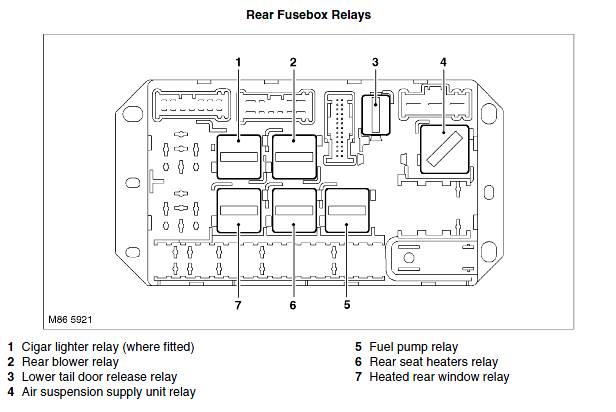

Does anyone know where I can find the fuel pump relay for an 04 RR-HSE? Apparently from what the shop told me, is that the fuel pump went out. Not I don't believe them, but I did manage to check all the fuses except for the FP-Relay so far. Replaced the fuel filter and that wasn't it. I'm about to remove the actual FP and buy a new one if that is the case, but first I want to check the relay.
If anyone knows where it's located, please let me know. I would really appreciate it.
