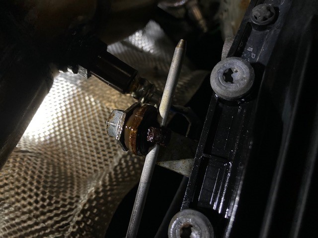

Looked at console, although I've been there before, decided to go for shift linkage inspection and adjustment if needed 1st. Its my wife's truck, her 'baby', so I rarely get to drive it. She said it randomly slips from 'D" to neutral anywhere (highway, bumps in the road, etc.) but shift light indicator stays on 'D'. Sometimes dash will read either 'D' or 'N'; completely random. I found that it will stay in Drive (D) if I pull back gear shift and hold it. Although never a fault on dash my Scanner showed transmission, neutral safety switch, and height adjustment. Has to be linkage. It took about 6-7 minutes, PB Buster (or similar) to break rust and debris, 13mm socket, and pull cable (pointed tip) north towards the front. It took a few small adjustments but works like new. I also put this on that previous thread 'popping out of drive'. Hope this helps.
Don't forget to chock wheels front AND back sides in case you adjust it to neutral...

My 2011 LR4 transmission was slipping out of drive to neutral so reviewed the photo and followed the shift linkage adjustment above. Worked great!

I seem to have to re-lubricate the linkage on my 2010 every 6 months or so. The shifter becomes progressively harder to shift and finally get the popping out of drive issue. Lubing works wonders
