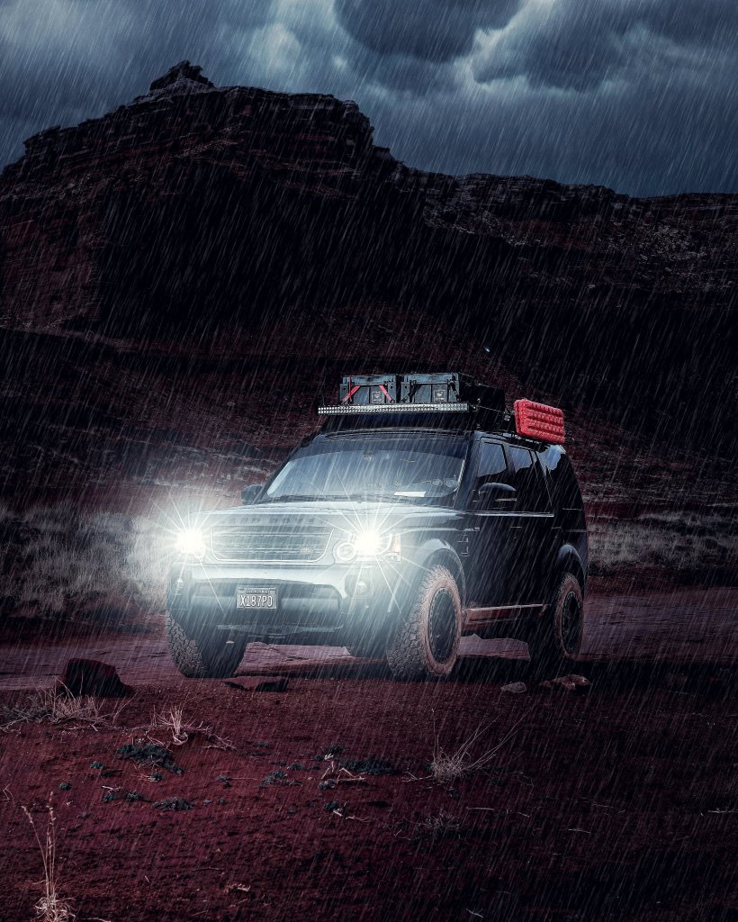

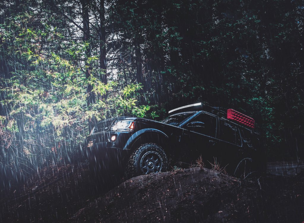

275/65/18 with no lift, no adjustment made with GAP tool.
I did have to trim the frame horns and remold some of the plastic in the wheel well.
First image is standard height, second is offroad height.
