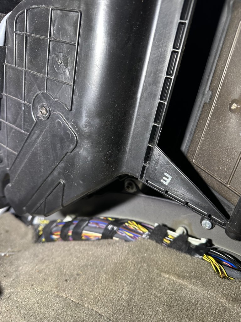

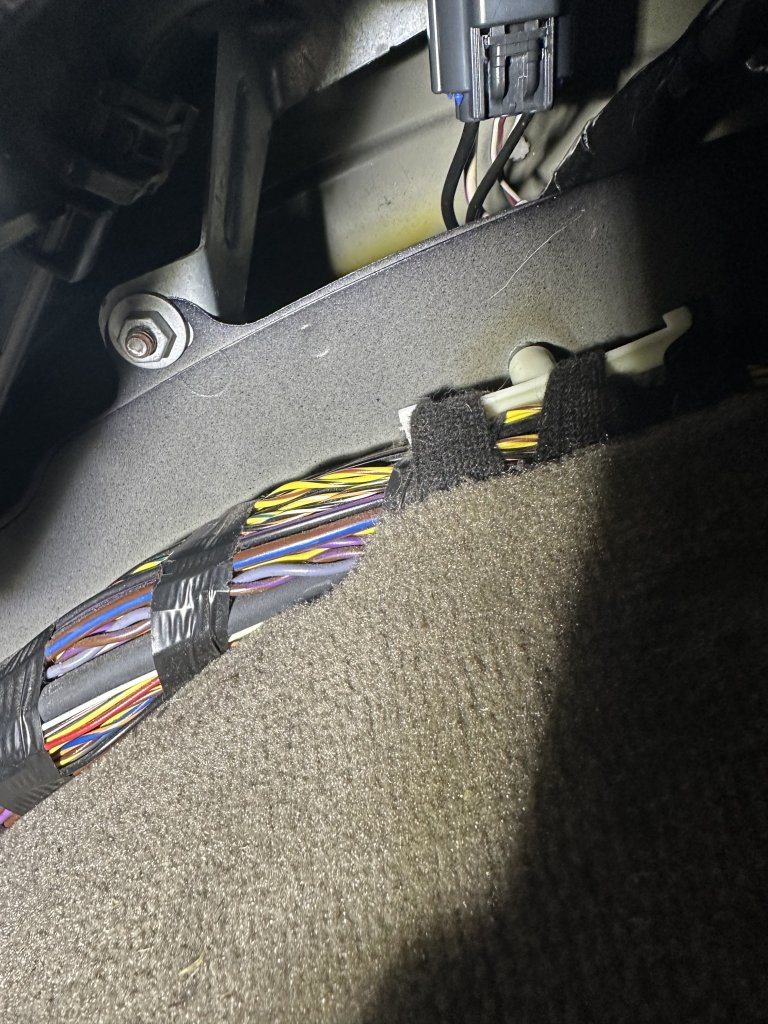

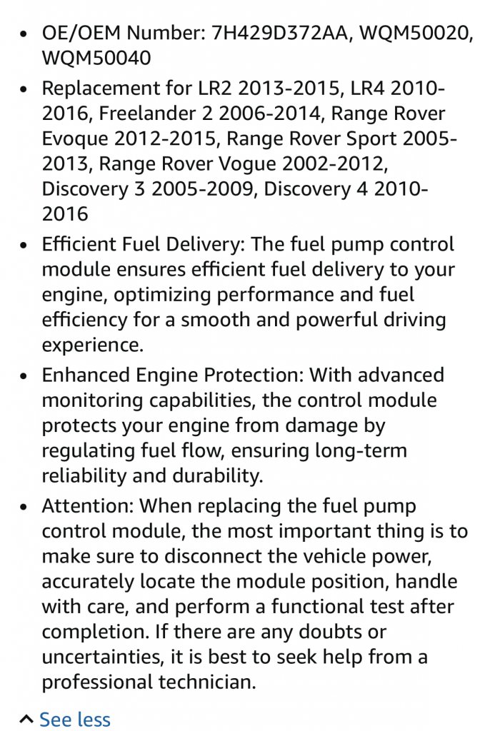

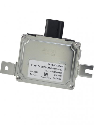

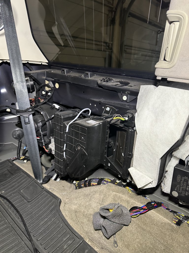

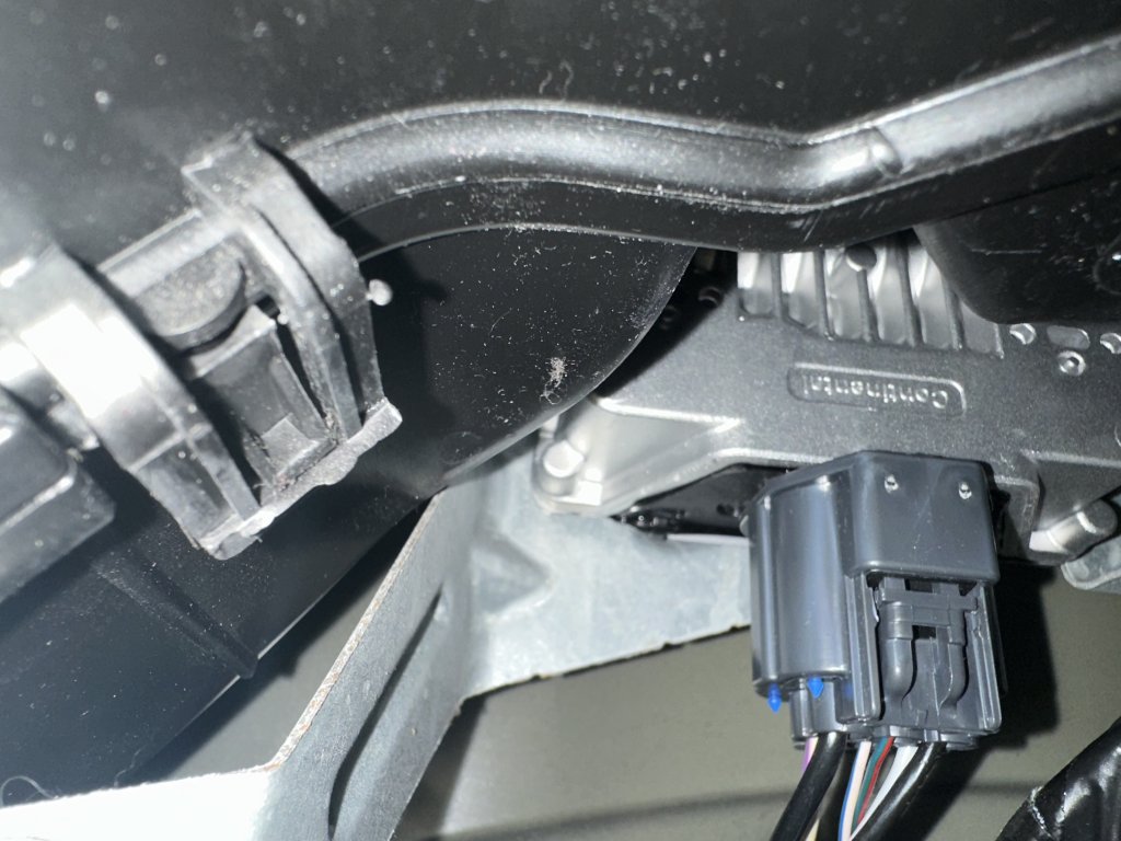

So I had p0089-64,p008A-07. Ran perfect, no misfire,no start issues. Dealer and my scanner can’t find anything wrong, code came and disappeared three time with engine light. Dealer thought may be low pressure pump going out. I changed that my self. Code went away for three and a half months. Then same code came back. Again all reading on scanner for sensors looked fine to me and dealer both, suv runs perfect but engine light was on. So dealer said Hail Mary passs- start replacing things. They suggested low pressure sensor ( passenger side ,near cross membrane, next to transmission bell house) as first t replaced. But on you tube there is excellent diagnostic video by opus IVS( 1 hr 22 min long). Expert said do fuel control module ( or fuel program drive module- Fpdm) change first as low pressure sensor is hardly at fail in his experience. It is very easy to remove trim driver side trunk area ( see powerfuluk video about it).I replaced fpdm and codes r gone. Feels like vehicle is running smoother too( didn’t have misfire before). Make sure to remove battery before u unplug fpdm and plug in new one. Fpdm in lr4 2015 driver side trunk trim removed as below in photo. Loosen 3 silver 8 mm bolts to slightly move ac components out of the way and behind duct fpdm sits, very intuitive.
Software update was already done few years back .

Thanks for this. What's the part number of the part you replaced please?
