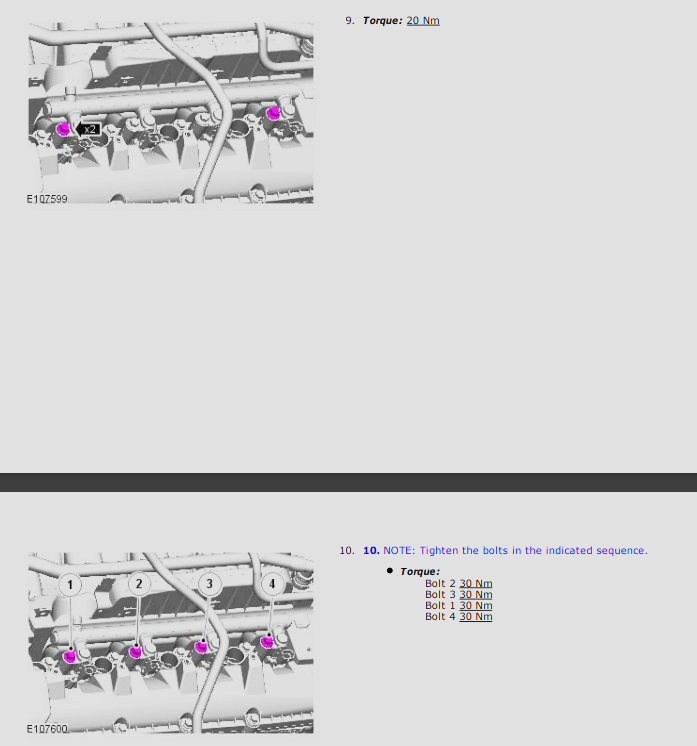

Reassembling after changing injectors. Can someone tell me what the torque spec is on the fuel rail bolts? 2011 LR4. Thanks!

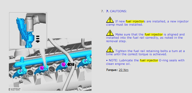

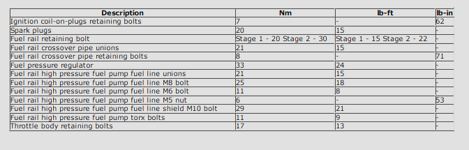

Thanks but not those bolts. The bolds that hold the fuel rail on down by the injectors. There are 4 on each side and you have to pull the fuel rail when you change the injector. I am reassembling it now but want to make sure I get those correct.
