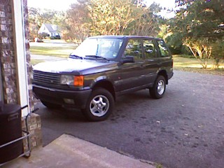

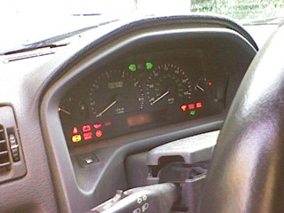

i drive a 1996 range rover 4.0 SE. there is alot of problems with my rover. but one of them is about to keep me from driving it. when i take off, there is a really bad and kindof loud banging like noise coming from the back underneath the car. i dont know if it is the transfer case,tranmission,drivesaft , or torqe converter. i was wounder what i should do and who to take it too besides land rover. also, my air conditioning and heat only works when it wants to, my dash like speedometer,tachometer, everything on the dash doesnt work and every light is lit up on the dash. and when i hit a really hard bumb on the road going about 55mph the front wheels start shaking and wobbling and the steering wheel goes crazy, i have to stop or slow down alot for it to calm down and drive normal. aslo when i hit a bumb on the road, doesnt matter how fast, the car goes beep beep beep , you know that little alarm in the dash. does anyoone have any advice on what i should do. PLEASE HELP, I LOVE MY CAR.
Sounds like a bad ground if the speedo, tach and others are not working... may also be a bad connection in the wiring harness.
also do range rovers have like a main computer in them?
Cause i forgot to mention that i installed a master cut off switch because when you turn the car off, the dash is still lite up and you can not take the key out unless you disconnect the battery or if you turn the switch.

Dang, I would say you having some diffent electrical issues... I hate to point someone elsewhere, but I would like to see you get the help you need.

you have a short to either the bcu or the cluster itself.
pull the cluster out and check for any issues.
and get rid of the damn cut off switch.
dont ever mess around with RR electronics. either wise you are replacing the bcu.
and paying a hefty towing bill and twenty five hundred dollars for the part.

With what your showing me I would say corrosion in the connections to the ECU or BCU...

instrument cluster is the dashboard,
the bcu is under the passenger seat.
