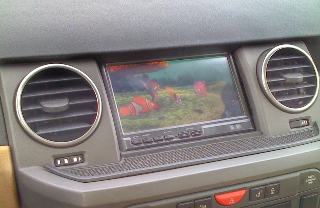

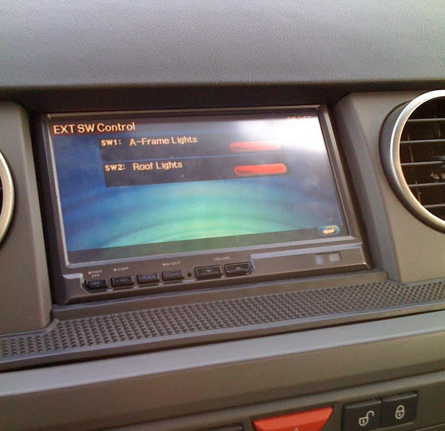

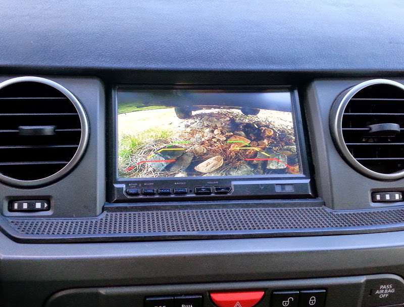

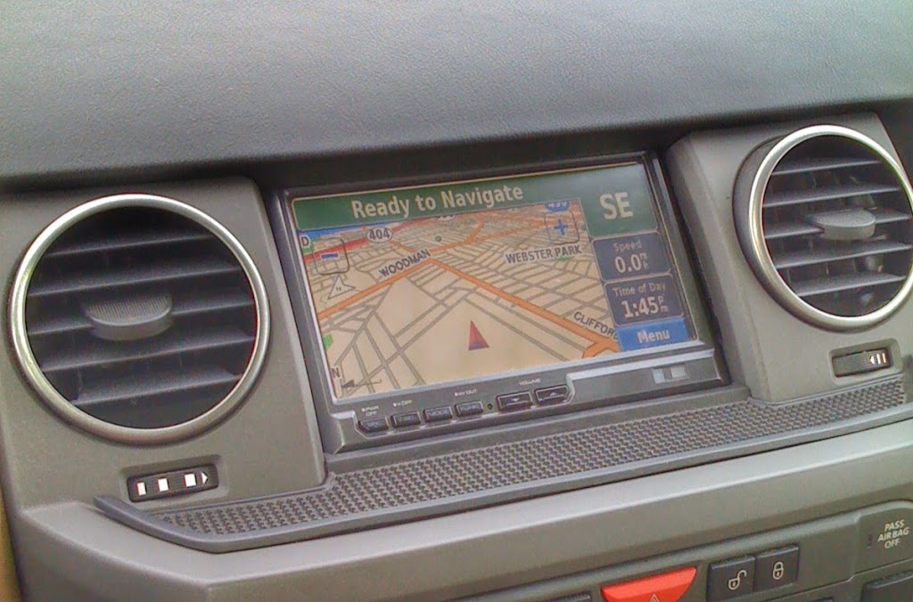

I have a garmin solution in my SE, but its not cheap or easy or even in production anymore. I was able to get 2015 maps for only $95. You could probably still find the components on ebay and amazon - some discounted nicely. Kenwood G510, KOSL702, and KOSV500
Video feed from overhead dvdplayer:
Under truck and backup cameras (auto switch)
Soft buttons for lights and now diff locker:
This is a 2008 solution and starting to look dated. If I had to start from scratch today, Id probably go with a 7" ipad or android tablet.

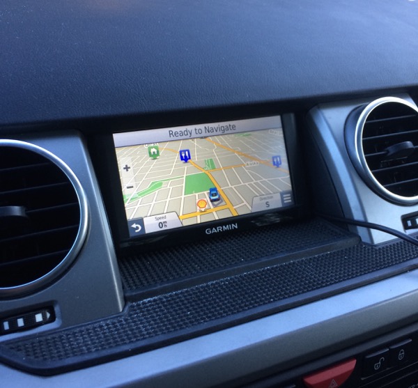

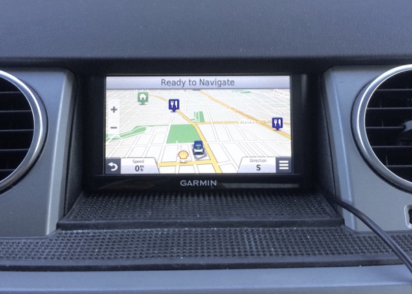

Garmin Nuvi 65 LM as in dash GPS
On a recent trip to Fry's Electronics for something completely unrelated I picked up a refurbished one of these for $99:
https://buy.garmin.com/en-US/US/on-the-road/automotive/2014-line/nuvi-65lm/prod140393.html
It fits perfectly in the center dash cubby and works like a charm. I plan to run the power cable from behind the GPS and perhaps add a little velcro mount - but this thing looks pretty close to a factory fit.

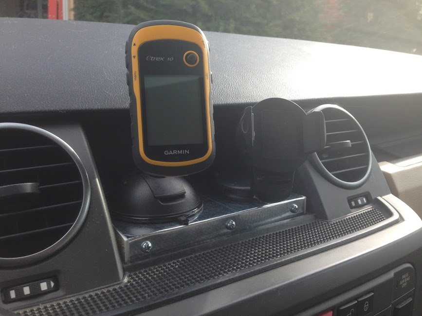

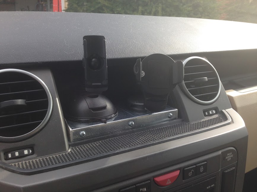

Here is what I did.. The mount on the left holds a Garmin hiking GPS for speed, location (latt and long), bread crumb functionality, and a trip odometer/average speed.
The mount on the right is for my phone, which gives me all the navigation options I could want. I no longer have to purchase map updates, plus I can use other apps if I like.
