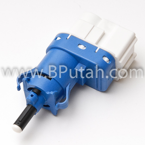

Picked up the LR4 today. They said it was a faulty brake switch. They replaced the brake switch and cleared the codes. I'm Not sure what a brake switch is. Didn't have time to discuss with service manager. Seems to be ok now.

The brake switch is a silly, $20 blue/white mechanical switch that installs above your brake pedal, it basically clicks the rear brake lights on/off and takes all of 5 minutes to replace. Unfortunately, when it fails / shorts, it has a cascading effect on a number of connected modules as they all "think" something is wrong with your brakes and go into limp mode by default, issuing all kinds of doomsday faults. Search the LR3 forum for "brake light switch", lots of stories just like yours... For a $20 switch. I carry one in my car at all times now.

WOW. Thanks for the info. I'm Amazed that such a silly little thing can cause all this!
