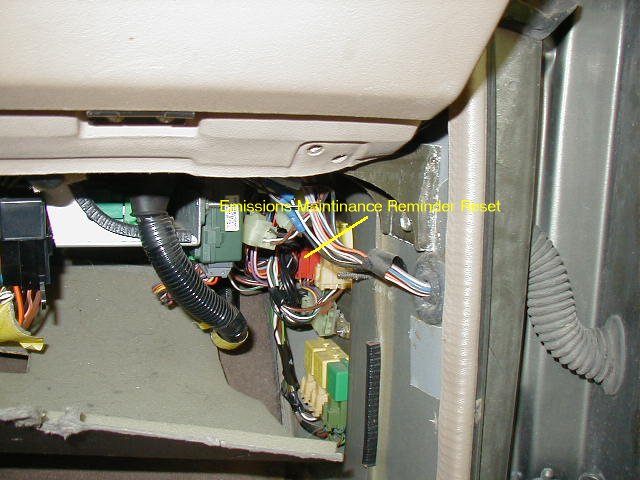

The service engine light comes on every 50K or so just so that you will take it to the dealer and get it checked. Mine went off at 90K. The panel on the front right passenger seat hides the box that you need to reset. Pull the panel, and you will see one that has a label with "emissions" written on it. Pull of the sticker, and you will see a small hole. Pul a pin, or small wire in the hole. This will reset the service light. Ask me any questions you have.
I have a '96 XD. 57K. CE light just went on. Looked for above mentioned sticker and none there. Instead found my LR CD changer. Suggestions on where to look?
Moose
Mar 12, 2004
1,082
Shamelessly stolen from another site:
D
discomike
Guest
Look in the right front passanger kick panel if your looking for a maintance reset relay. Us a paper clip and punch a hole thru the Rover emblym to reset, if it is for mileage, if it is a check enh=gine light get it scanned.
Slam - I have seen a couple of threads about this "Service Engine Soon" indicator light. Does anyone know if it is possible to turn it off on the 4.6 HSE Range Rovers?
M
Mark
Guest
I called LR in a coastal city in NC and talked with the service rep. This 'Red' light does not have a time limit to turn off... Say after 500 miles.
I asked if an OBD II could remedy this light, the answer is some may...
I then asked if I disconnected the battery for 4 days, would that work? Hestitation...in the response as wellllll, it might not come on without more errors...maybe the degree F will become degree C ... problems ....
So, if I poke the hole, will it permanetly disable the Red Light? or what?
I intended to have the 90K maint. perfrom this summer, but I did not want the red light on until then.

On you '98 disco, check out this and it will solve it, or just remove the little box that is mentioned in here to never deal with it again:
http://204.157.1.3/reset/index.htm
M
Mark
Guest
Thanks Joey. I tried the pin push first, with ignition on, and it did not work. So I took it out.
Light is not on anymore.
I think this emission controller is nothing more than a clock. Right?
No feedback to anything else like the ECM/U.
I can drive in peace.

It is basically a mileage clock, at approx 84k miles it will turn on the light, so it will kick it again around 168k approx.
It is a nice money maker for LR when you don't know how to turn off or reset. I have been running without mine for almost 2 years, and no issues.

Rather than suggesting the pin in the hole routine, let's just state that it takes 4 minutes to access the emission control box and disconnect the blasted thing. Quicker and cheaper.
