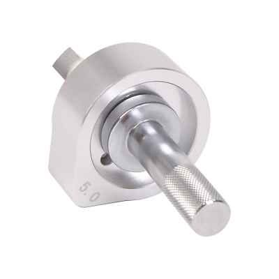

I cut the oil pump bolt for the sprocket and removed the sprocket and bolt, that chain aint coming off without opening that chain so, looking at the new chain and notice besides the two links marked for the crank and fuel sprockets there is an obvious black link. Thinking of opening and replacing the chain and being done with it. The tool,
Land Rover Jaguar 5.0 3.0 Fuel Pump Camshaft Aligner Alignment Timing Tool Kit | eBay
is for supercharged engines only, I was wondering why the &^%$ I could not apply it.

You would also need the tool to reset the fuel pump drive timing.
Thanks for sharing your experience. I discovered that my aux chain was loose while doing the timing chains. I almost set the truck on fire when I read the oil pan had to be removed. I managed to remove the tensioner with a little creative tooling.
I have the crankshaft & cams locked, and the old parts removed.
How did you deal with re-timing the fuel pump? I've been scouring the internet and repair manual, but everything is based on the oil pan being removed. I have the timing tool, but it's not apparent how I line up the timing marks.
