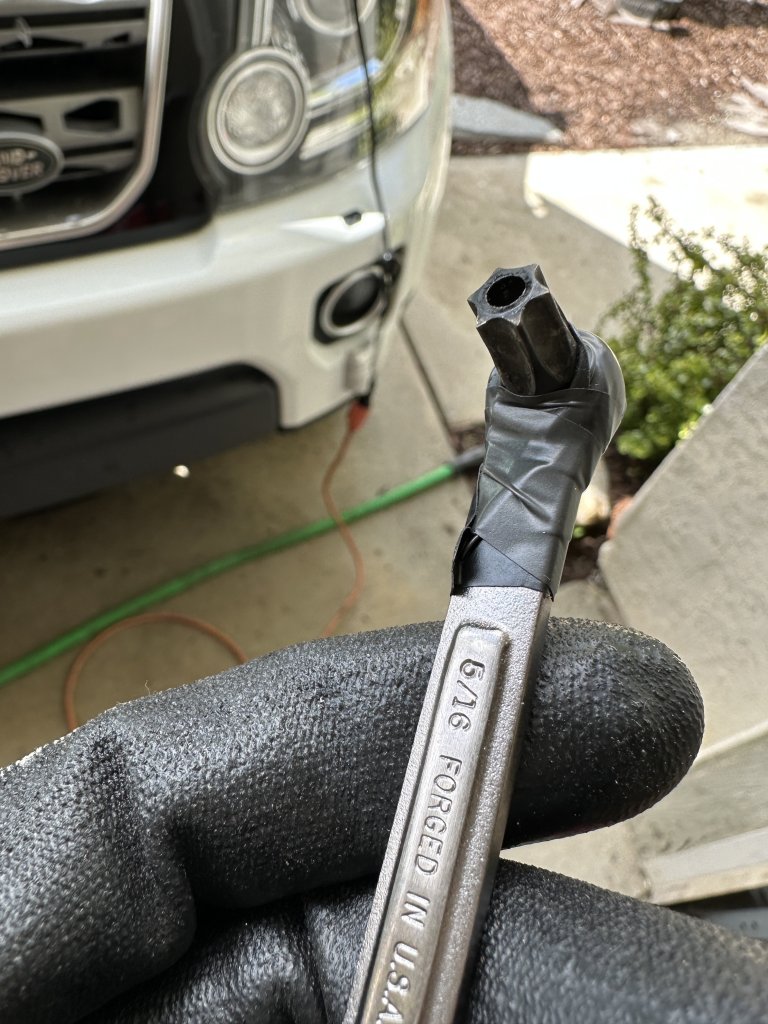

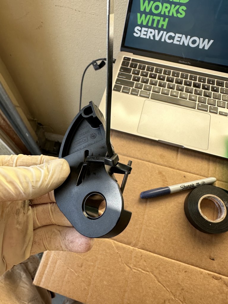

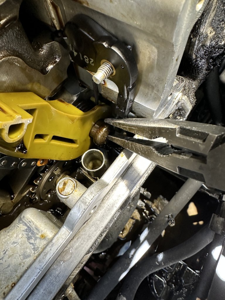

I just replaced the auxiliary tensioner without dropping the oil sump. It was annoying, but not too difficult. I was doing the timing as well, so the car was already apart. It REALLY made me wonder why the LR engineers didn't factor in an access hole to remove the bolt.
Removal
1. I made a special tool - pounded out the bit out of a T45 torx socket, trimmed the torx bit to make it as short as possible, taped it into the end of a 5/16 wrench
2. Use the special tool to break it loose, then needle nose or 90deg pliers to back it out until it's out of the threads
3. Pry the bolt and tensioner out - requires a bit of force (make sure nothing drops into the oil pan. watch out for the spring to go flying)

1. Install a nut on the new bolt, trim ~1/4" off the end of the bolt. Run the nut on and off the bolt until it threads as smoothly as possible.
2. On the new tensioner, use a zip tie to secure the sprint tensioner close to the body (this helps with clearance)
3. Make sure the bold is as clean as possible (you want to avoid tool slippage)
4. Install the bolt into the tensioner and place a small drop of oil on the tip of the bolt
5. Holding the top edge of the tensioner, fish the assembly back in place (may take a few tries)
6. Start the threads - I used a pick in the center of the bolt to hold it in place
7. Cut and remove the zip tie
6. Tighten the bolt - I used a combination of needlenose & hose grip pliers, and the tool I made

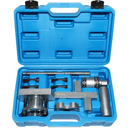

You'll also need the fuel pump timing tool when you realign the auxiliary chain.
You'll also need a crankshaft puller/installer for the LR4 engine. You might be able to remove it would a loaner tool, but re-installing is going to be an issue without the proper tool.

I used a universal crankshaft pully removal kit to remove the pully and didn't remove the radiator. However, when I used the LR kit (mentioned in my previous post) I DID have to remove the radiator. The installer bolt is too long to fit with the radiator installed.
The shop manual says you need to disconnect the AC lines, but I was able to leave them intact, detach the other cooling elements, and remove just the radiator. There are 6 screws (3 on each side) on the front side that attach the other elements to the radiator. The front grill unclips, providing access to the bolts. Take your time and be VERY gentle so you don't damage anything.
